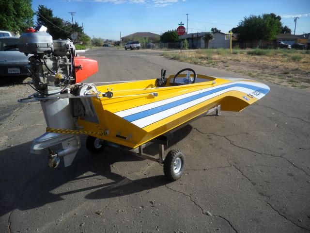

It is difficult to tell from the picture you posted..........
.........but from the angle of the photo the motor looks to be slightly "tucked under". By that I mean if you took a straight edge and put it parallel to the prop shaft the other end of the SE would not be parallel with the boat bottom, but be closer to the bottom at the far end than at the transom.
As you are probably aware, this adjustment is critical for the boat to ride properly and not run with the bow in the water. Your Hydro should run (when you get it correctly set up) with the trailing edge of the sponsons about a couple of inches off the water.
You want to be careful and make this adjustment in small increments so as not to take a chance on blowing the boat over backwards, although your boat seems to be large enough the chances of that happening without a real screw up in the "kickout" of the motor would seem to not be great. If it were me and I was starting from scratch, I would set it "dead level" or straight/parallel with the bottom. (prop shaft)
When you get your starting problems ironed out you might want to have your son use a video camera to take some video of the boat running WFO past him in good water. You can tell from the video if the boat is getting too high in front and the sponsons are too far off the water. Some boats will also reach a certain speed where all of a sudden the boat feels really free, like you are "floating on a cloud", and the nose of the boat will kind of "pop up" several inches. This can also be accompanied by a "rocking" from side to side like one sponson is lifting off the water and then the other. That is actually what is happening and is called "spilling air" and the boat is trying to relieve itself of the extra air it is packing under it by rocking from side to side because the angle of attack of the lower unit is two far out from the straight line of the bottom. At that point you want to back off the throttle and slightly tuck the motor back the other way, as you are getting on the edge and could get wet.

[QUOTE=bill van steenwyk;212861].........but from the angle of the photo the motor looks to be slightly "tucked under". By that I mean if you took a straight edge and put it parallel to the prop shaft the other end of the SE would not be parallel with the boat bottom, but be closer to the bottom at the far end than at the transom.
Bill looking at the video he posted on the 1st page the boat drags the sponsons at full speed. So boat riding to low."Keep Move'n" life is catching up!
