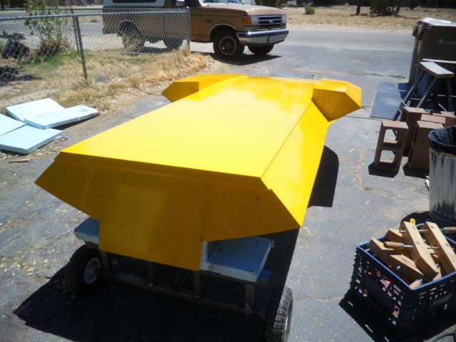

        Here is a picture of the bottom of the hull while I was painting it.
        Bill

          You have no air traps. Suggest you add them. Details are available if you do this. Easy to do on your bottom to chine design.

            • traps
              Not on your design. That type construction was used in the 1950's 60's and typical examples are Sid-Son hydros, Swift Hydros and Hal Kelly designs and others. I have a Kelly Wetback that I raced back in the 1970's. Your bottom design is Wetback like. The traps are added after the non trip chines and the bottom are put on. Email Me and I will give you the details with pics on how to do it - real easy if you have a table saw and some basic tools.

                    • wetback
                      I built a Wetback like yours in the 70s and started racing with a 20H popper. People smarter than me pointed out the lack of air traps. I took some pine (I think) and beveled it and tapered it from the sponson to the transom so that it ran to nothing at the transom. Made a difference in how the boat ran. But then I sold that boat and bought a used Bezoats and finally a Giles hydro that I still run the old Mercs on. Those boats were much better than the older Wetback design. As long as you are just a lake racer, you boat will be fine, although probably not as fast as you might like or feel safe with.

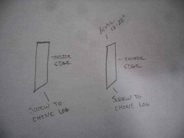

                          Anyhow, ... I got the info and pictures. It looks like a very simple mod and I have a ton of Philippine Mahogany I can use for it.
                          Would it be beneficial to put a small angle (12-22 degrees or so with the inside edge being the high side) to the bottom (not the matting surfaces) of the added pieces? Also, .. how do they act while turning. I was under the impression that the aft end should slide somewhat, but then again, ... what do I know.

                          • air traps
                            Bill
                            The email address in myCP is the same one I gave you in the previous post. Don't know why it does not work?
                            I am not following the 12-20 degree angle you are asking about. The rear vertical edge of the traps is what holds in the turn, only minimum side slip wanted. Once set at the rear right trap it acks like a rail with the fin doing holding on the left sponson, takes getting used. Another reason why you sit farther back and set your butt against the right cockpit side in a turn.

                              • Here is what I was talking about,
