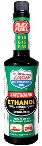

I have been doing some reading about ethanol with it's nasty effect and how I'm not going to find it easily in southern California. Although, ... I have found a few forums that have recommended this stuff from Lucas. Has anyone tried this or think it is worth a try?
These products are about stopping corrosion due to the alchohol in the fuel. They also stabilaze the fuel and keep it fresh longer. I use Sta-Bil that does the same thing for preventing corrosion and keeping the fuel fresh. None of these additives can remove the alcohol. In your case when not using your engine for awhile just drain the carb and the fuel tank and if you have fuel that you will store just add some Sta-Bil or other such products.
for your limited and short term use, don't worry about using ethanol ............it will be just fine............just make sure you use a good quality 2cycle oil...............
