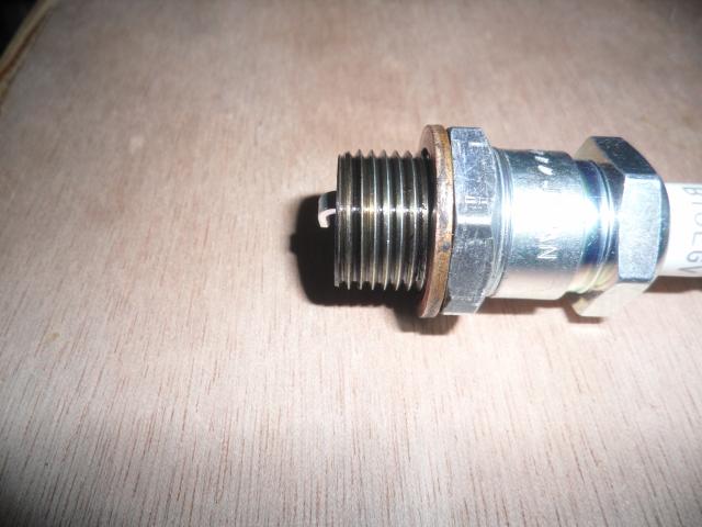

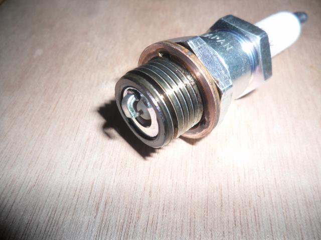

    I installed a new pair of B10EGV plugs and gaped them then at .025" I noticed that they are VERY loose when screwing them in all the way to the plug gasket before I tighten it a 1/2 turn with a plug wrench.
    Could the soot on the threads be going between the plugs and the inserts because there is to big of a gap between the two? Maybe I have some cheap low quality inserts?
    From the pics of the other plugs you replaced the fit was loose with thosa as well.
    The plug should fit in the adapters without the excessive looseness you describe. I run them with that plug and no carbon is on the plug threads like in your pictures. You have a poor fit and that will reduce the plug heat transfer to the block, not good. Get some proper ones from Ric Montoya or Tom Johnson tjohnston@localdialup.com or Tom Cronk tcronk@tampabay.rr.com.

          Gezz you sure are getting lots of advice here. The reason your plugs have carbon on the end of the threads is because the threads protrude into the combustion chamber. They are long reach plugs. Which is ok. With 18mm to 14mm inserts make sure the insert does NOT protrude into the combustion Chamber. Why, well I have seen motors with burned pistons with long inserts.

              The threads DO NOT go past the insert length, in fact, the threads are slightly recessed. The soot on the ends of the threads is from gases going down into the thread gap on the 14mm side. Also, the soot and fuel residue is climbing into the 18mm threads as well. I also measured the depth of the inset and those threads are not in the combustion area either.
              Conclusion, ... the plug inserts need to go.
              I don't see any other conclusion from the photos.

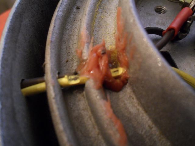

                            I have found what appears to be another issue but with my kill switch wiring. The starter pulley is rubbing away the wires. The wire IS exposed and I get a positive continuity on both wires when grounded to the engine.
                            The top of the starter pulley is .065" above the crank bolt hole. Could I shim the starter pulley with a washer to raise it up slightly to make clearance for the wires? Clearly I need to redo the wiring. It currently has a 4 pole trailer plug. I think I will opt for something smaller and maybe a twist lock connection getting rid of some bulk. I'm sure the wires will be less fatigued if the plug doesn't weigh as much.
                            Sorry for this dragging on guy's, ... But I do want it functioning in top order.

                                I did not intend to infer that you needed a free ride but someone may have one that is just using up shelf space. I looked through my stuff and have only Y-80 heads and they are 18 mm. Don't shim the pully just reroute the wire. Jack
