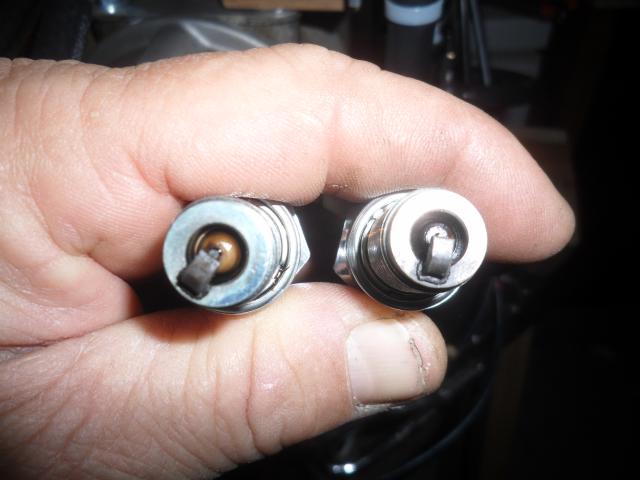

        I pulled the plugs and had a look to see how they were doing. The bottom is a nice reddish tan but the top plug was darker in color.
        Question:
        I am using #10's for the plugs because I was using an 18mm head with inserts, ... Now that I am using a 14mm head without inserts, should I go to a hotter #9 plug?
        Plugs are pictured. The one on the left is from the bottom cylinder.

              Bill, first off, seldom (if ever) should the motor be "kicked out" (rear of prop shaft higher than front of shaft). A good baselline to start is 1/8" kicked under (rear of shaft lower than front of shaft). Second, you need to move back in the boat after you get it on plane. Use your body motion to adjust the proper attitude of the boat. Planing on depends on the prop and setup and with the motor kicked out, you will have a harder time doing so. You only need to move forward in the boat to "set" the turn fin when turning or maybe in a rougher water condition or windy condition...............get in the back of the boat and "let it fly, BUT FIRST, get the appropriate safety gear, as if you do eventually get pitched out of the boat, you always have a VERY good chance of being hit by the prop, which will definately cause SERIOUS injury!!! Atleast get some kind of helmet to protect your melon!!!
              B9EGV or BR9EIX plugs, will do you well, but 10's will work fine also for your use......

                      I know the thread has moved on but boys and girls we still have problem
                      with the power head. Those plugs should look almost the same in color. Don’t like that top plug. What do you think Bill Van or Daren.

                          I agree this is a very good inexpensive way to assure the advance stays where it needs to be. Also the top plug looks to be lean. A carb adjustment may be in order.

                              • Not sure how one would adjust a carb to make one cylinder run richer on a multi-cylinder engine that has one carb.
                                Maybe it has something to do with the reeds?
