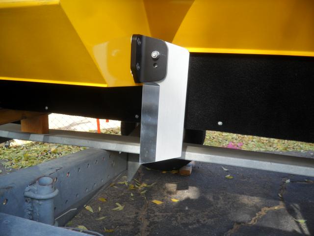

                            • Turn fin?
                              1) This Spartan is a 10'(?) version of what I had as kid, the Tiny Titan 8', on which I cut my racing teeth and got hooked for a lifetime passion. The hull has almost no lift, flat compared to any 'racing' hydro, and as we've discovered, no air traps. These designs were Popular Mechanic weekend build boats, got thousands of kids on the water for endless hours of freedom. I'd be surprised (as would you) if you ever got enough lift to flip over. That said, keep testing, kicking out 1/8 at a time to get the sponsons up.
                              2) Watching vid where you're doing numerous left turns, I do NOT see telltale spray one would expect from a fin.....there should be some spray, I see nothing, indicating either you have not installed fin, or it's not down. That is why you are compelled to lean over strng wheel to plant left sponson edge to bite,...and still sliding. Pls confirm whether fin installed and down. If you had the fin down, you can extend reach shifting weigh back, raise front, even in turns. Maybe I'm wrong, pls confirm. I do not even see it installed in your pics.
                              3) I suggest you apply the fin, shift weight back before installing air traps, which might be eventuality, and tilt engine out a bit more to compensate for no lift.
                              This is a great community project!
                              Ps: my TT was also canary yellow, w 9.9 Merc, tilted and shimmed to the moon, thought I was coolest boat on the lake, a Yamato on 10' is cool!

                              • Originally posted by hydroid View Post
                                Hi hybroid,
                                Yes, it's a 10'2" big brother to the Tiny Titan. Kicking out proved to not be the answer, ... it resulted in taking forever to get it up on plane. Hence, ... adding the air trap.
                                A Lee Tietze fin is on, ... and down. In fact, I wonder if I have to much fin hanging down, 6.5" below the sponson. I guess I could rais it up to the next hole, but that wont allow it to kick up if I hit something. I also could machine it down if needed.
                                A couple of reasons to why I am leaning on the wheel. 1st It's the pivot point and 2nd, ... I didn't know any better until I was just recently told I am sitting to far forward.
                                I was wondering if I should hold off on installing the air trap until I tested it with me kneeling in the correct position, but as you and others have noted, ... this design doesn't have much lift if any at all and it the reason for adding the air trap.
                                As far as the yellow, ... It's a lake racer and I wanted to be as visible as possible considering how small the boat is.
                                Bill
