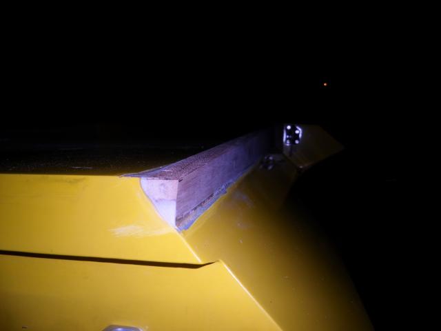

                • I have been watching the last set of videos in 1/8 of real time and the sponson's are up and flying 90% of the time which is new, so I'm wondering if I can get them higher once the air trap is shaved down a little.
                  It seems that if I can get the air to release around the back 20-25% of the aft-plane that will let the transom down a little which should relieve some of the force pushing down on the sponson's from having to much lift at the transom.
                        Does this sound correct?
                        Also, ... What do you think about making a jack plate for my motor height adjustments, ... it will also bring the motor 4-5"or so inches further back?
                        Bill
                        Bill
                        First trim the traps as I previously noted that is make the trap zero at the rear but trim in a straight line from the rear of the sponson to the rear zero point. Then we look at the ride and if needed trim some more. You are going to have to get in the rear and just do straight runs, let's get the lift right then the turns are next. We do one thing at a time.
                        Forget the jack plate, I believe the hull will ride right with set up and prop.

                            • Last night it was 36* out and I planed down the air trap pieces when it wasn't raining. Got it done and covered but I am not able to go today. I'm shooting for tomorrow.

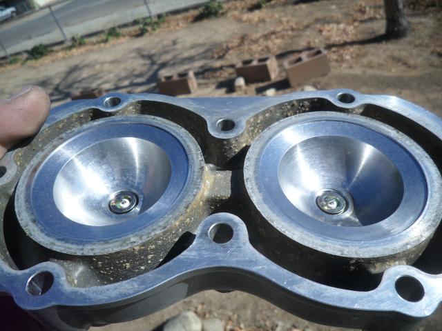

                              Anyhow, the spark plug indexers showed up this morning, but to my surprise, ... they gave me two packages instead of the one I paid for, ... looks like I will call them on Monday to see if they want to send me a return shipping label or not.
                              I installed a pair of .064" indexers, and it looks like these ones will index the plug and recess them a tad, a win-win.
                              I'm going to toss the motor on and get the height and angle dead on, ... 1-1/4" x 0*.
