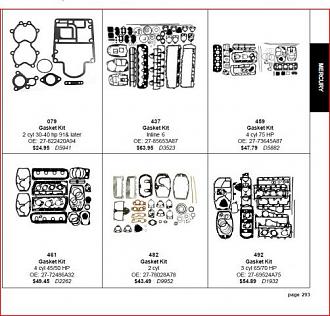

    Pro Marine
    I have found a very good place to but Mercury parts. Dave Scott up in Canada told me about Pro Marine. I needed rings for the 44XS we were building and found them 30% of what Mercury wanted for them.
    Here is their website http://www.promarineusaonline.com/
    There phone is 800-621-7761
    I have down loaded their catalogue for easy use. If you have a business you can open an account an account and get a discount on their cataglogue prices.
    The prices are very good and each time I have called the parts were in stock and were shipped the same day. I did not see points in their catalogue but you can give them a call. Also they have OMC and other engine parts. Good people to work with.
    Alan

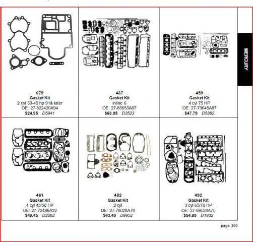

      Pro Marine
      Sample page.
      Alan
