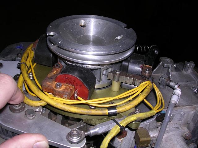

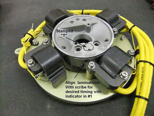

              44 Ignition
              Over the years I have built a lot of four cyl. Mercs. The one thing that most people have trouble with is ignition. The old magnetos usually are a big problem to the inexperienced builder. Mag setup is like a black art. Some can do it some cannot. Took me sometime to master. I would advise a new builder to consider using the later style Thunder Bolt system or a aftermarket unit from Roskowski. We have switched to a system from Electromotive Ignitions. We have found this system to be dependable, and it has alot of advantages, such as a completely programmable ignition curve,easy to start, no more fouled plugs. The disadvantage it is not cheap. Racing to win is not cheap. I am presently putting their newest unit on one of our 44s. Will post photos when I complete it. I do have about 6 Mags setup and ready to go at a reasonable price if anyone needs them.
              Art K
                Art, where did you get you system and which one is it? This is the web site I found:
                http://www.distributorless.com/index.php
                  Electomotive ignition
                  They do have a web site. Phone #703 331 0100 ext.217 ask for Uwe, funny name but very knowledgable. This is not a simple bolt on project, lots of fabricating. Lot of wiring. I am using the XD1 system. Be sure to tell him that it is a 2cycle.
                  Art K

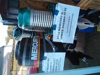

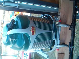

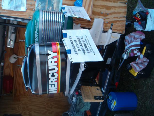

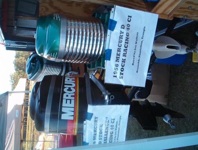

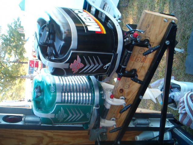

                          Three Wienandt Built 55 H's for Sale
                          I have Two 40 c.i. and one 44 c.i. Bluprinted powerheads built for me by Jerry to the specs and with the correct parts for the 44 as detailed in his write up. Also have a complete file on each powerhead with asembly pix and Jerry's droll coments as he proceded thru the machining and asembly. He even named them, "Old Standby", "Booger", and "Super Thunderbolt". They are all mounted on fully restored 55 H towers with rebuilt gearcase with all new components. All are Perfect and strong runners, not just show motors. After 58 years with racing boats the Doc said to slow down. I also have many rebuilt or new 55 H gaskets, mags, cone nuts, Hansen 1:1 gears, cowlings and pans, and more. Send me a E mail and I'll send you a attachment with a detail sheet and price list of items I have for sale. Thanks for looking. Jon K Walters walters@plantationcable.net
