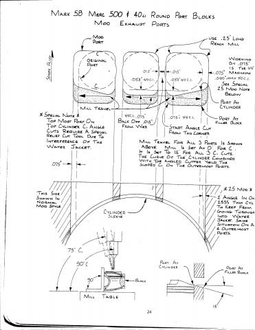

          Thanks for the kind words Dave. Well to be truthful I am in discussion with a couple people on what way to go with a new gearbox. The first option is to digitize my last new D gearbox and see if we can get it hoged out of a block of 6061T651 Alum. With today's NC machines it might be possible. Second was to design a whole new dual pinion gearbox that can be used for both MOD and Pro.. The idea would be to produce a unit that would live a long time without having to replace gears but retain a small frontal area. If there really is a need and enough folks want them then I will seriously consider going forward.
          Now back to the MOD engines. For anyone that is considering a MOD program I am posting the Harry Brinkman port design from his notes. Doug Kay follows this profile for all my 40 and 44 engines and is setup to do it right. There are varations you can use when setting port height so that you can set the RPM range and courses that you run on.
          Alan

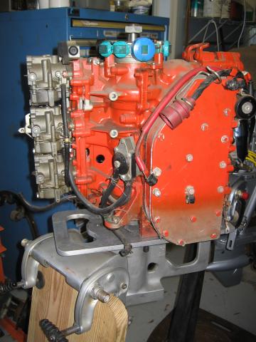

              Building a MOD 44
              We are finishing up the work on a spare Mercury 44XS powerhead and needed some parts. The ideal engine is a Mercury 450 from the 80's. We were able to get a donner engine for $100 in less then a few days looking. The powerhead would be ideal to make into a mod engine. One note of caution. If at all possible find a engine from a fresh water area in that it will be far better to use.

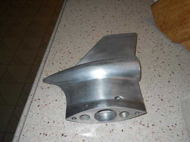

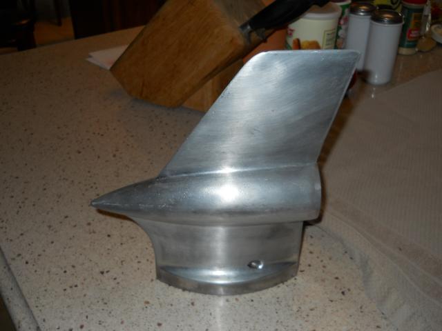

              Here are a couple photos of my last D foot I have. The Mercury 44S used this housing. The process that made the casting for the unit was a lost foam casting process which did not produce the highest quality casting. My intent would be to copy this item and true up the dimensions on it. We would also build a shaved sided unit for MOD and stock housing for 44XS. Right now David an I make shafts, cones, water pump cartridge, and back up ring for the D's. Prop shafts might have to be made soon. Gears are available so all we really need is a housing. I would like to know if there is a real need to build one.
              Alan

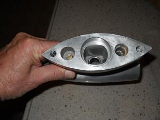

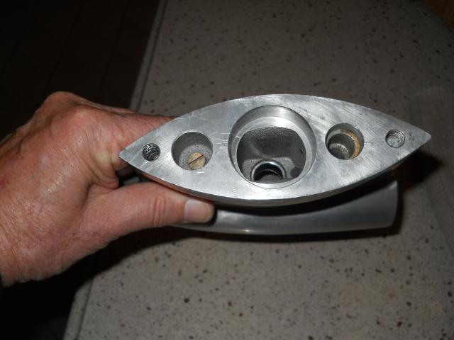

                    Found a photo of my 3 holer on a brinkman tower. Lots of work needed to get it ready.
                    Alan
