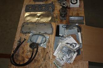

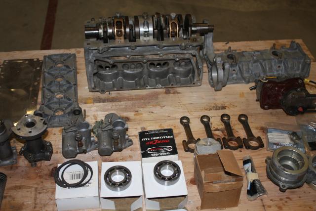

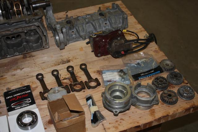

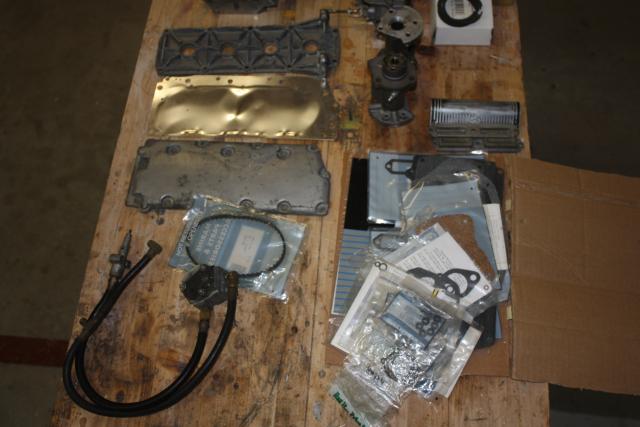

    This is my newest project. I bought this 44 basket case. Looks like a good way to get the feet wet and I think in D mod a back up motor is a must.
    Humm now where to start. Little different than building boats

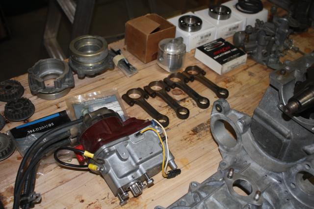

      Since this motor is a 1963 or 64 engine what year did mercury go from Points/Mag to electronic ignition and is it interchangable with ease? Then do you have to carry a battery to power it?

        Ignition and reed cages
        There are a lot of ways to go with the ignition. The clasic Mercury magneto, which I prefer, the later Mercury self energizing CD which has componets that look like a mag, the 44XS system where you really would have to start with this engine which has a taller crank and a very large and heavy flywheel with is used for electrical power generation. None of these systems require a battery.
        In the after market area a number of options are available, some of which use a battery. One unique one is made by Steve Roskowski which is fairly easy to install and setup and will not require a battery. One thought must be considered is are you willing to give up a little HP to drive the power requirements over and above the elecctrical needs. Any of the belt driven units will eat a little HP due to friction and windage in the unit. Secondly, if you have a rotating mass, i.e. magneto it will slightly slow down the capability of the engine to build RPM due to its inertia. This could be a small factor on a short course if you have to back the throttle down in a turn and then open it up again.

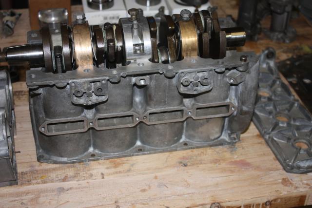

        Reed cages are in the engine for two reasons. First they are a key component in the induction system and secondly they act as a bearing and seal between cylinder pairs. Brass by its nature makes an excellent bearing and with an gas/oil mix of 12:1 will live a long time at the high RPM and loads imposed on them when running as a MOD engine. I like the large slot brass for that reason even though the aluminum cages flow a little better when used in the induction system. As the reed cage wears the sealing function of it is diminished thus reducing crankcase compression. When building the TX444DK we removed this function from the engine and use external reeds. Photos shown above in this thread We also inject oil into the reed cage to handle the RPM we are running, 9,000 +/- to make sure we don,t heat them and have more than enough oil in it.

          Merc went to battery ignitions around 1970. There is no change to the hanger bracket and they are easily interchangeable.
          Harry Brinkman was successfully using self energizing magnetos on his C Mods at 9,300 rpm, but that may be the rpm limit of the magneto system. It may be above the rpm limit of some magnetos and some guys setting them up.
          The advantage of the magneto is it is less complicated, weighs less than carrying a battery and as available used is the cheapest ignition for these motors. If I recall correctly there are several Merc electronic ignitions and one of them does require a battery. The supposed disadvantage of the magneto is as Alan stated, the magneto places more drag on the motor thru the timing belt. Not all of the resistance of turning the mag is the mass of the internal rotating parts, there is also drag from the bearings and friction from the belt itself - but mostly magnetic force from the internal magnets and coils generating the electricity for each spark. I never heard anyone concerned about the windage inside a magneto before. I would not be surprised to learn it is nearly equal to the combined friction of the points cam follower and the force to open the points. It would be interesting for some AP student to do the math on it. Another disadvantage of the magneto is the points assemblies require maintenance. The cam follower wears, the springs loose tension and the points wear from friction and arcing. Three other maintenance parts are the bearings, the rotor and the carbon brush for the rotor, but these are rarely problems.
          Some people feel the aluminum cages are less rigid and do less of a job holding the block rigidly around the crank.

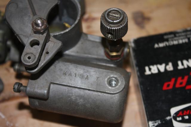

          Above idle the KA carbs are essentially the same except for the depth of the nozzle in the float bowl. Alan and David sell replacement long nozzles. You can make extended nozzles yourself, but its hard to beat their price.
          I used adjustable main jets until I checked out Rich Fushlin's equipment and asked him a few questions. I have had success with fixed jets since then. A problem I ran into with my best pipes was the pipes made the carbs run lean with the largest jets Tillotson made for the KA's. I solved the problem by drilling the jets out until they were too rich. Then I went back one drill size and filed the jets with a welding torch tip file until the size was perfect.
          Not only will fixed jets not go out of adjustment, they will show you things like whether or not some other tuning makes a real change. Bike and snowmobile tuners will tell you, if your pipes do not make your motor lean, they aren't pulling in any more air. With adjustable main jets, you are never really certain there has been a change.
          The advantage of adjustable jets is its quicker to make a change for different atmospheric conditions or maybe a load difference like a different prop.

            Thanks for the replys Alan and Sam. I guess I will have decisions to make. I do think for us the adjustable carbs maybe the way to go since a lot of our races are at 2000 feet or better and then we go down to sea level to play with SOA.
            One last question. Are there different types of reeds and reed stops avaliable to? Seems like there were a lot of options on these motors thru out the years. Is that because the basic motor was in productions for such a long run? Do these reeds loose tension over time?
