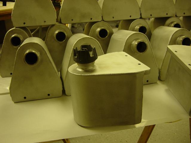

              • Fuel Tanks
                I have a number of new fuel tanks that mount on the tiller bar. These tanks hold about 1 1/4 gallons of fuel. The cost is $245.00 with shipping.
                Alan
                apvw1@aol.com
                • Originally posted by OldRacerBU View Post
                  Alan
                  apvw1@aol.com
                  I bought two ot these from Allan and they are of high quality and very professionally done.
