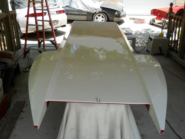

    I was refinishing the bottom of the heavy hemp we were running and when I checked the bottom it is far from ideal. The new boat will hopfully work in C MOD and B1 when we start running that next year also.

              Dan, I am sure you had a fun ride at Rockaway Beach in the Hemp with the 44XS on it. The side has been strengthened and the boat refinished now. I will post photos in a couple days after I finish the bottom.

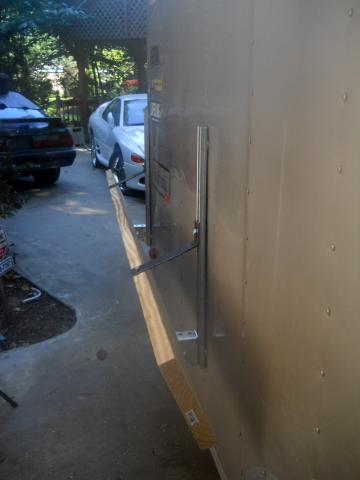

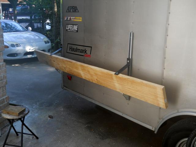

                  One thing that I found out when you run a number of clases and have to switch engines there is never a good place to put the engines. This idea is not new but I thought I would post photos of our solution. It took less than 3 hour to fabricate/install and about $50 in material. I used an 8 ft 2x10, conduit support channel and hardware, a 3/16x2 inch steel strap and four lag bolts. The motor board can be installed and removed in less than 5 min with only a 3/4 inch socket.
                  I found the corner of my trailer to have a heavy steel angle and the support for the inside boat rack picks up the other end. If someone need more detailed photos let me know.
                  Alan

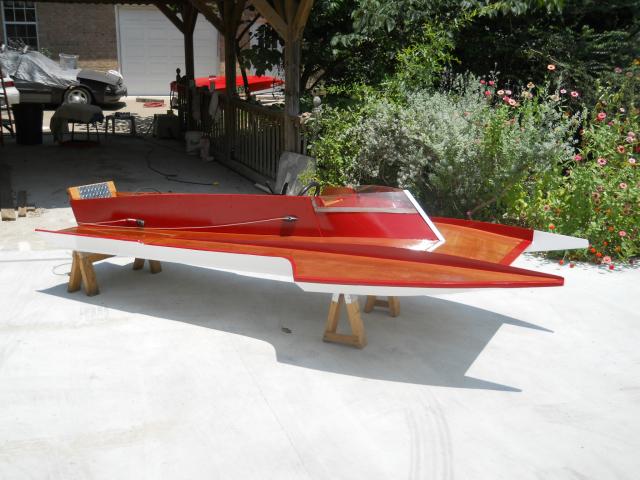

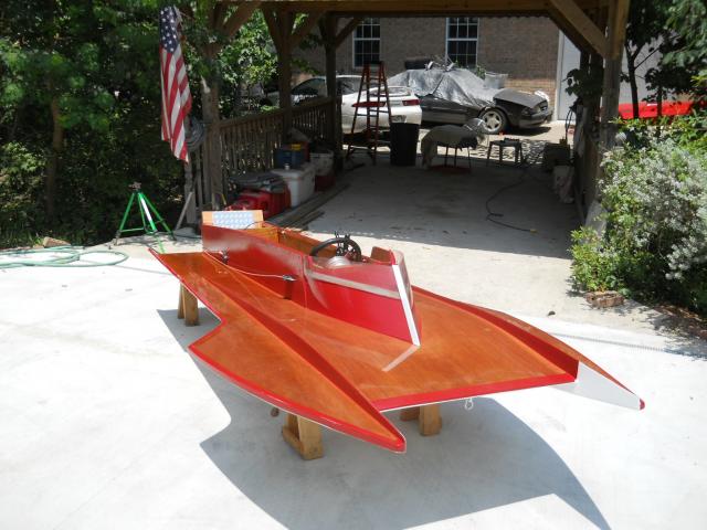

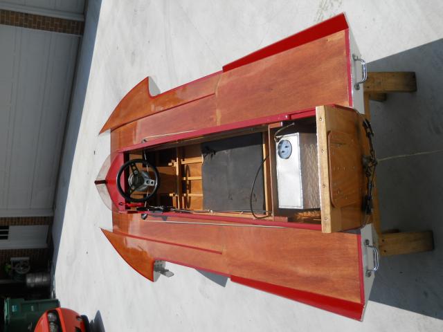

                          latest progress report. One coat of epoxy and now first coat of Varnish. Hopefully it will get up to 95 again then I should be able to wet sand and put second coat on tomorrow.. And then we can flip it over! Speed building is not a lot of fun but would be nice to have another national champ in the MRC resume.
                          Now it is time to tear apart the C Mod exhaust and see if I can spot a problem there. I have gone thru the rest of the motor and found nothing yet

                            Alan I thought all of your boats are pure white. What happened to the one picture above?

                              Aeroliner Boats
                              Hi Mike
                              Alan and Jr are on the road to Centrailia, in Missippi and hour ago heading north. This Hemp style boat shown above came along with a 44XS engine, had to buy the whole rig. Presently the boat is in the trailer heading north for pick up in Centrailia by and old racer from the 50's. He will be using the 58H ( I know Mercury never built one but APBA did have one in their specifications) Doug Kay built for me and I sold to the good doctor from Minn.
                              Dan C drove the combomation of the 44XS and the Hemp at Rockaway Beach earlier this year. He had the thing turning so tight he put his butt thru the right side of the cockpit. All has been fixed and made a lot stronger.
