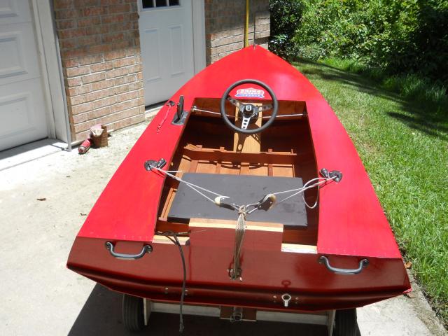

    Here is a new boat being build for Allan... C Mod monster

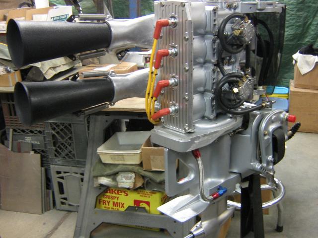

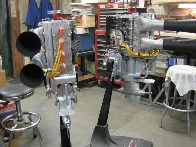

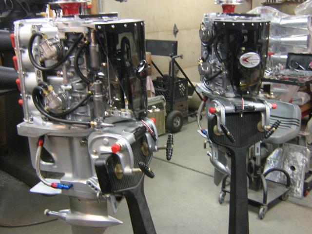

        The boat is really starting to take shape. This item will replace a Hemp that was to big for our needs and put us a little to much over weight. Below are photos of the C and D Mercs Doug Kay built last winter. The C can be found by looking at the lower units. The D has a shaved one. Mike, look at the way we do our fuel pump systems.
        We run mostly in NBRA and at least once in APBA a year up at the IOA race at Hillsdale MI. The D engine is running well and is competive at the present time while the C still needs to be setup with a ligher boat and then some prop work.

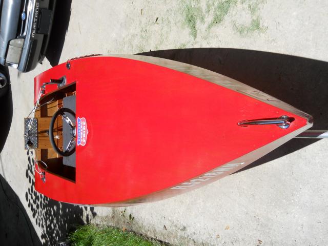

            My goal is to try and make an all wood boat that will be as close to 100LBS as possible. Then all Allan has to do is keep it on the water

                The NBRA folks will most likely be running A MOD runabout at the long course nationals so we have decided to run one of our runabouts with a 20-H on it. Hopefully we will get 5 boats at least. My brother David an I have been building the Speedliner M-510 since 1965 and this boat is one we built a couple years ago.

                  Alan, First question is how do you feed the upper fuel pump.. Maybe I am missing something. Is there a third line coming off the lower fuel pump?

                    Fuel system on 30 and 40
                    Hi Mike,
                    We will get the stickers to you. I have a couple but we will make sure you get a bunch. I have checked the fuel systems in two engines and have not found any issue with them. All is normal.
                    If you look close we us the mercury fuel pumps with three ports. On the lower pump all three ports are used and the upper only two. If you don't have one I will send one to you. Fuel goes into the top of the lower pump and out the front top port to the lower carb. Fuel then will bypass the lower pump and goes out the aft port to the aft port of the top pump. The center port is plugged. The front port delivers fuel to the upper carb. Then both carbs are tied together so you wind up with a very balanced fuel flow and pressure to both carbs.

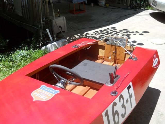

                          I am working like crazy but the heat is killing me. I had to get up early just to get the bottom glued on before the epoxy went off..

                            Boat looks great! Should be a fun ride. The boat from where your at now looks like we will meet the weight target. Now I have to work on my son to loose about 20 lbs. Well thats the hard job.
