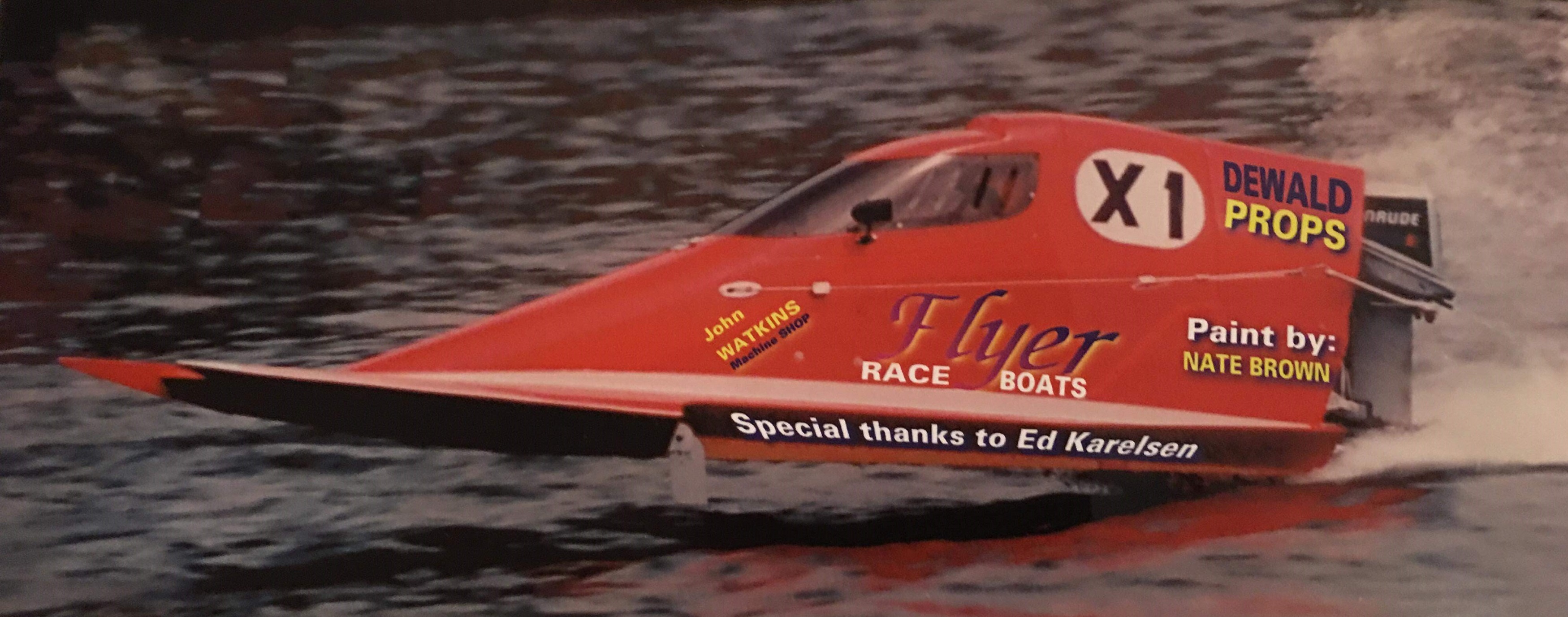

ID:	468084 Andrew found it and sent it to me...
    Here is the Flyer ASH Capsule Boat.

      Now that is a cool boat. And an A boat at that, problem is it is an enclosed cockpit. I don't want to get involved with an enclosed cockpit because then you need a restraint system and breathing air......extra money and weight.......but at least there is a proof of concept hydro out there......

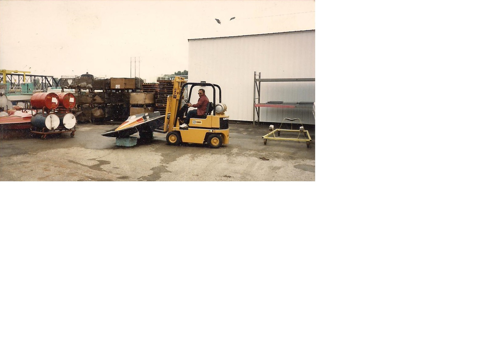

              Joe, Here's the only pic I have of the boat I ran as It was being picked up by a forklift to be tossed into a dumpster after I brought it back to Mercury Marine. I borrowed it from them. It was a glass boat that A J Nardi built for Sport C or similar but a lower profile than other Sport C hulls. As I got it, it had plenty of hook in the sponsons, mostly due to shrinkage in both his mold and then again in the part. So I overlaid plywood on the sponsons to get them flat and blended that all in. It really ran good and was fun to drive, would go over rough water well. It was free enough so I almost blew it over once.
              I helped Del Snyder with the design of his boat which was a slightly smaller version of a 45 boat. He may have pics of it.Click image for larger version
