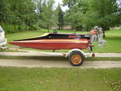

Name:	TEXAS HYDROSPORT WRANGLER 01.jpg
                  its my understanding there was a class of Fiberglass sitdown tunnel hull boats in Texas and they may have run Y102's some time ago.
                  anyone know anything about this?

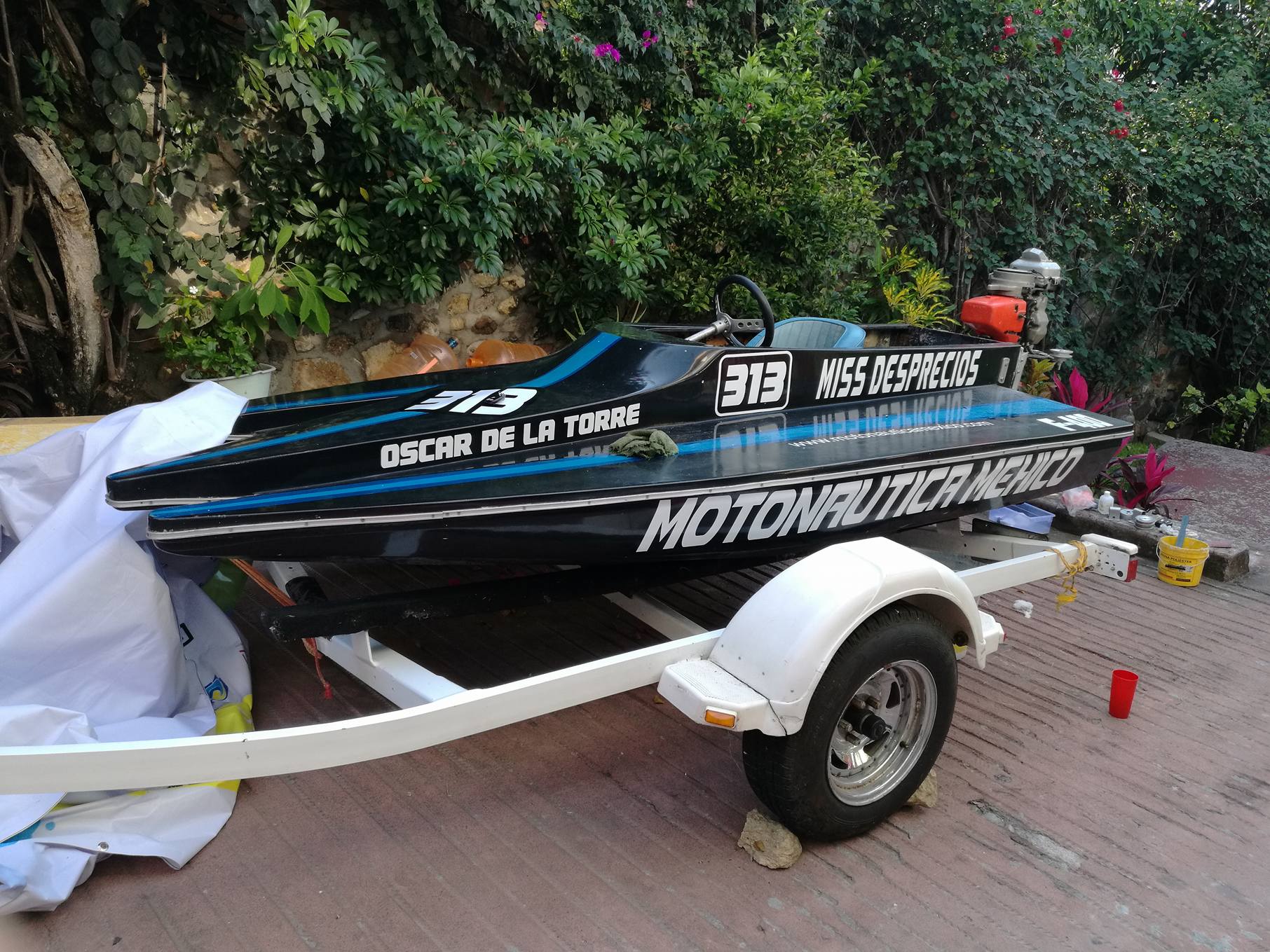

                    There is a gentlemen named Charles Large that lives down in MX that owns a set of molds for a boat just like shown above. I have talked to him a time or two on FB and I believe he got the molds from somewhere down here in TX. I believe he has the molds in MX with him now.
                    This is a picture of a boat pulled from those molds.
                    RobClick image for larger version
                      PERFECT, thanks
                      I have been told for a couple years by many people (in the know) that this wont work, no way it can get on plane with a small prop race motor, Ive kept digging for info as I didnt believe it. now that I have both the hull and motor and see for a fact its already been done I will go ahead with setup and see if it will make me happy
                      thanks again, cheers
