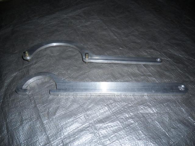

                      I made a few tools already besides the height and angle checker. The starter pulley can be used on either side and was made with .250" aluminum and the tail cone wrench is made from .375" aluminum. These were made from scrap aluminum cut on a band saw. 15 minutes each and saved me a bunch of money.
                      Any more tools I need to make? ... Just post the picture of what the tool is and I will make one.
                      Bill
