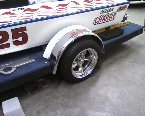

      Boyd has just completed adding the brace, gas tank, new trailer axle and wheels, plus the tack in the dash. Woo Hoo, Boyd! all that is left is the motor.
      O ya!
      • Chargin Charley
        Ok, so the wheels and tires didnt work. When Boyd added the motor to the boat the trailer almost hit the ground, so now we have to get new leaf springs and different wheels and tires so the trailer doesnt drag on the ground, what the heck is up with that? So no testing at the Montana race this weekend! Bummer!
        • Not so fast Lucy......Went to Antique Auto Ranch and found some 1930 something spring to repair the 1930 something original spring leafs, added a center bolt, pounded and pounded, got them apart, put 2 extra leafs in, now 10 total and found some rusted wheels with the right off set, and remounted the new 6 ply trailer tires and we are pushing it out into the daylight for trailer light wiring. If it tows, (now only 1/8" off square instead of 1 full inch) I will head out early tomarrow and finalize the assembly at Trout Creek! There should not be 2 races in a row without flats! Boy, I'm beat up!

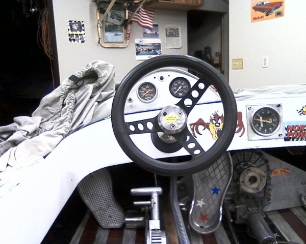

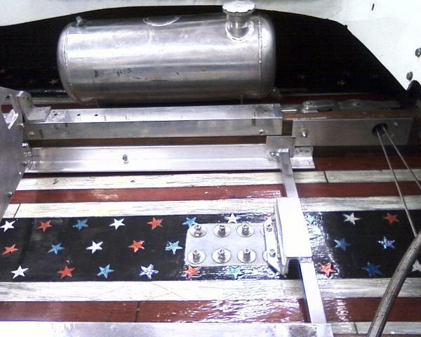

          • Proof
            Here is the current almost! shot;
            • Dang
              Well its 2 am Sat morn and I am not ready to travel. Boat needs the hydraulic throttle mount made, a fuel filter bracket fabbed (fuel tank has bits of alum inside), driveline shield mounted, seat brace drilled, header collector welded on, opps, I wont make it! Guess there arent any other flats there anyway! Would have been a good test, I'm too old for this 16 hour thrashing!
