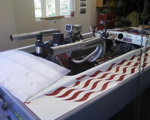

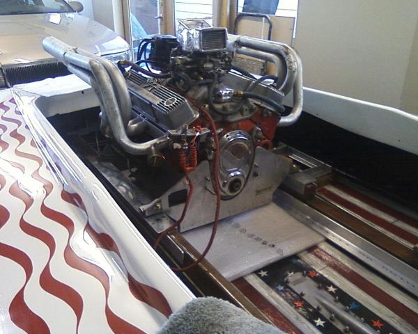

      • Hey wife, post pictures of the motor sitting in place! or resume your rocking!
        • Charging Charlie
          Engine sitting in Charlie.

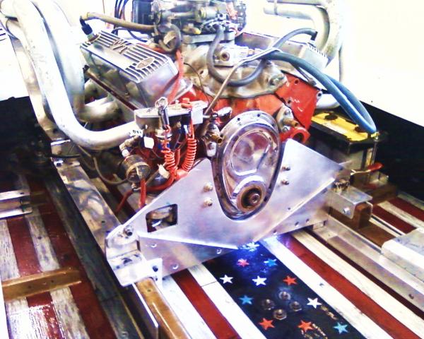

                    Nice picture!! Spent another 4 hours finishing up the motor mounts, now it has 4 engine rails, one on top, one on the bottom and the sbc slides perfectly parallel to the stringers!!! Whopps, who forgot the lock bolt? Whoosh

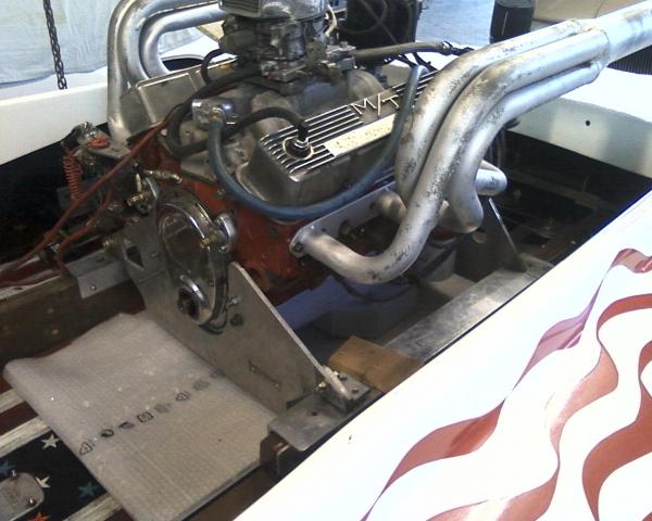

                          Thanks sugar plum. Yes, big block header braces will work IF you want them to, and are quite necessary since the 1 1/2 tubing is very thin. Flowmaster 2 in 1 collectors solved the rusted out former collectors.

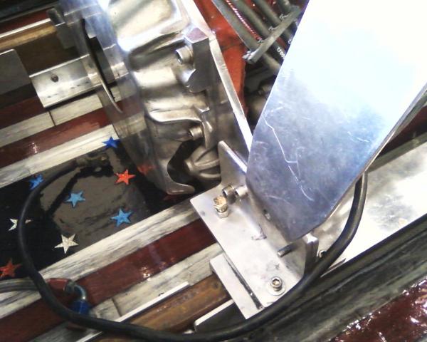

                          Hey Kevin, you dig my angle finder checking out the 2 angles of the vintage flame arrestor?? Thought so! Wiring & gauge is temporary!
                          That front mount was not the original for the boat so I had to add material for two reasons: I want to slide the motor forward or back to balance the boat with the power reduction required for SE. I dont think it will carry the nose with less punch and my prop gearing. Secondly, that dropped stringer on the drivers side needed additional strength so the bottom rail was added and those angle additions are bolted to that bottom rail as well as the original 3X2 inverted top rail. Below this, was all the torn damaged stringer wrapping, now filled with new glass. I dont want the stringers to twist at all but stay solid for 4 more decades!
                          Most fast racers of today rely on full length engine rails to stiffen narrow stringers and keep bottoms straight for more speed. Lance Faulkner, SS70 Kilo record holder could extract a few miles per hour from this concept alone. It's a labor of Love for the first all glass Javelin (modified Jones).
                          Thanks all of you for your encouragement and Bills Welding for his help since I cant weld worth beans! Oh, two cordless drills have now expired! Craftsman tolls arent what they used to be!
