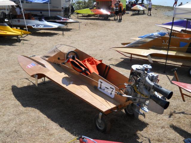

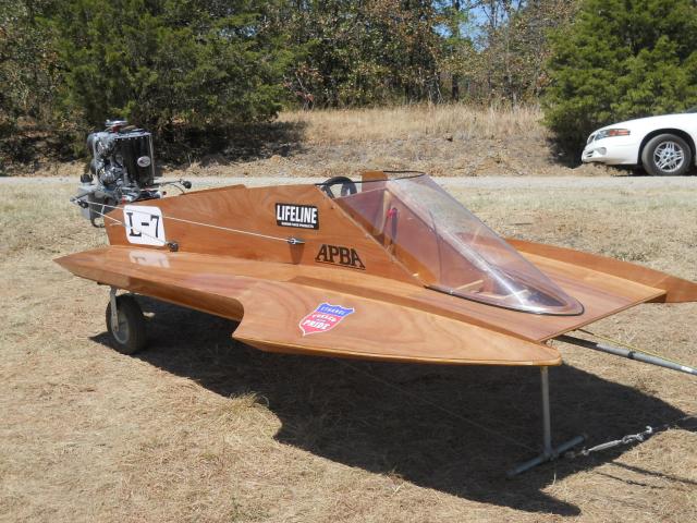

      MRC C MOD Delivered
      Hi Mike,

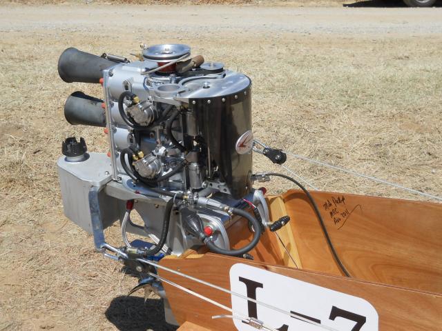

      Outstanding build quality. Everyone that has been following the build of the boat on HR at the race had to come over and see the new boat. Much thanks to Roy for delivering it. Might have to make this a yearly event! The most comments I received on it for your workmanship was your not going to make this one white! Guess it will have to get its last coats of varnish and it will stay a gem.
      We will have to continue the Testing in the next couple weeks where we will work on props and the lift of the boat to get the balance set where my son likes it. The boat turns likes its on rails. The tiller bar tank will have to be replaced with a tank at the transom to get the CG a bit better.
      What a great weekend, ever though my son jumped the gun the first heat because of the vastly improved acceleration. We were the only Merc in the field so we will have to work a bit harder with the props and setup.
      Alan

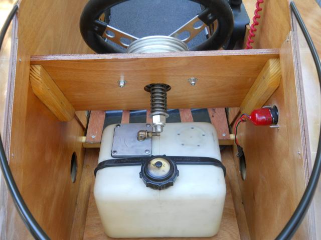

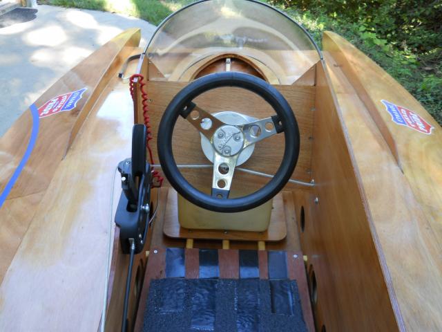

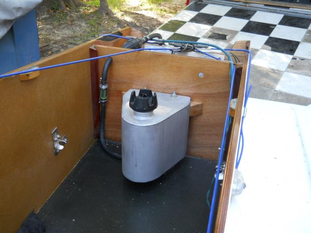

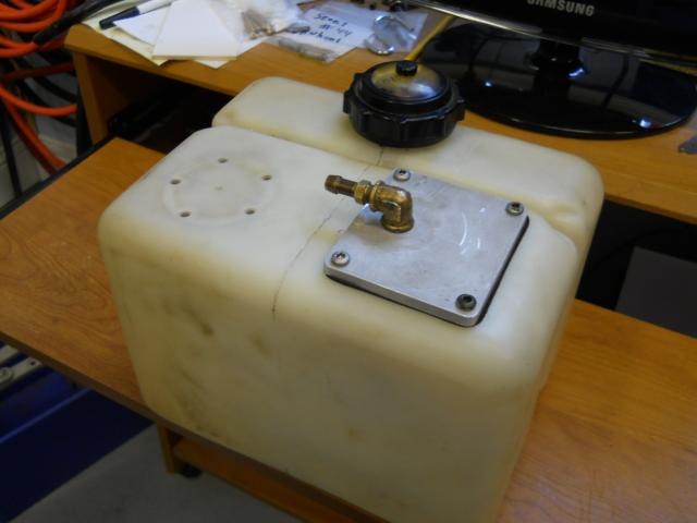

            Tank moved to front
            As we work to get the C MOD more competive we have decided to remove the tiller bar tank and put a tank forward of the wheel. I had an old Merc oil tank that looked like it would be ideal. It holds about 1 1/4 gallons of fuel and is two pounds lighter then the tiller bar tank. To help with the CG movement forward we also will use an Alum tiller bar saving 1 1/2 lbs. When we looked at all the weight elements the forward fuel tank, when the tank is full, will develope about 145 lb-ft of nose down moment while reducing the overall weight. Total cost for the front installatinon was less than $15.00 already having the tank.
            While I was at it I also installed a tiller bar tank inside our Roskopwski D/E MOD boat. This should help a bit with the CG issue we were having with the tiller bar tank.
            Alan

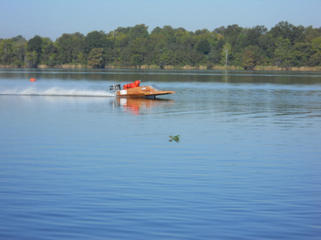

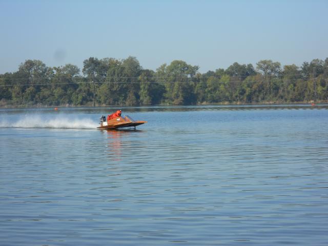

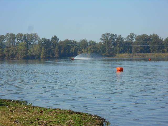

                    C MOD testing
                    This weekend we went to Pineville LA for an AOF race. The weather and lake conditions were outstanding. Our prime goal was to get our new MRC C MOD boat sorted out. The tank forward really helped and then we tried adding weight to the bow in 3 lbs increments. 9 lbs worked well and we went one more step to 12 lbs. No change noted. We also started adding tuck to the engine and that made the boat run well. We seeing slightly above 70 MPH with our two blade wheel and the prop shaft below the bottom. Next time out we will go up 1/4 inch and try some additional props. The boat is now comming alive. We ran 6 full laps of a 1 mile course and never had to lift the throttle. Hope you enjoy the photos that I will add from my laptop.

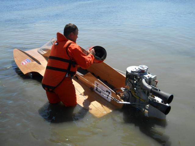

                        Hi Mike,
                        Again everyone at the AOF race enjoyed your workmanship. What was more fun was seeing the folks shake there heads when Alan Jr was running the boat with more than a foot of air under the sponsons. A couple folks even thought it was a D MOD. We will post one of the photos a friend took when we first started testing.. All in all the boat is really getting understood. We have a bit of engine work to do with carb adjustent and moving the timing up a bit. I think were going to move the tank another 12 inches forward so some lead can come out. We might want to add a little to the air traps in the back to force more air under it which should also bring the nose down a bit more.
                        Alan

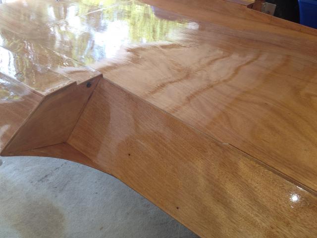

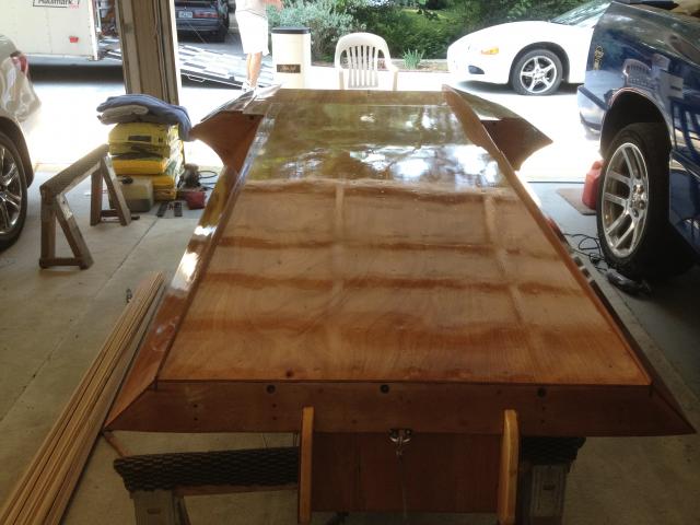

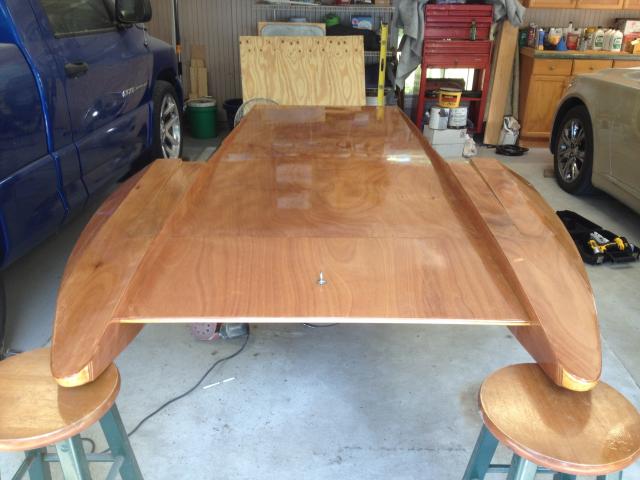

                                Alan Jr has lost 24 pounds and we will remove the 16 pounds of lead from the nose. Made a couple other changes also. Now have the fuel tank about as far forward as we can get it. We also modified the air traps to bleed off the air to help get the boat in trim. Today we did the first coat of varnish after the wood work. Tomorrow a second coat and we will be ready for the first NBRA race at Rockway Beach. The boat was moving quite well at Lucas until we holed a piston. Engine is all back together and is .030 over so we will see how it runs with a fresh set of pistons.
