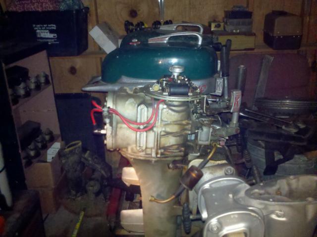

                  Hooooowwww... eh hem... I mean, baaa... baaa... So the easy fix is to spline this powerhead to the output shaft and tuck it under the cowl and go I guess.
                  • #39
                    Yes, maybe.. The sleeved shaft would be easier than mounting the power head. You'll need an adapter plate & the cooling would need attention. Ive seen it with counter-sunk fasteners one way, studs the other. It could be overkill too. LoLs You also have to consider more HP doesnt always mean more rpm so unless you do something at the prop you could end up with a 10 mph dragster. Must admit, as a RaT maker I enjoy this thread.

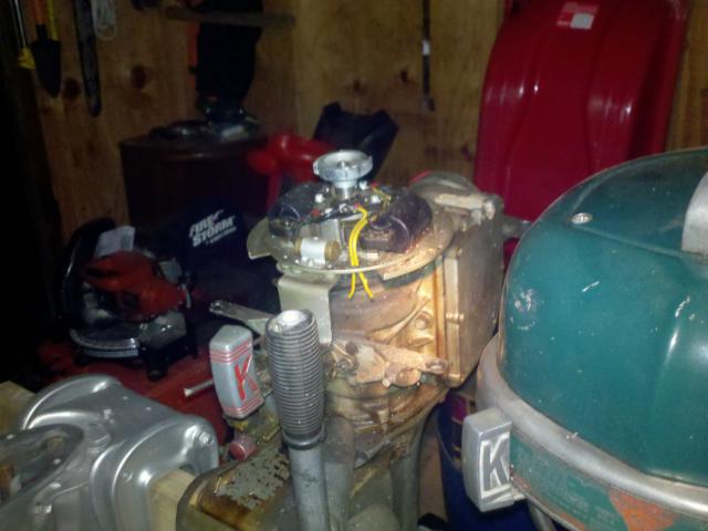

                          thank you Mark 32! I have some breaking info on my mill... It is a 1978 evinrude fishing motor. Ill post the serial # tomorrow morning if anybody wants to look at specs and parts on brp. The merc motor that I want to borrow the head off of just will not fit under the cowl. Not even close actually. So... I am shoping competitavly! Found a match for a powerhead that is mine to really do some voodoo on, and not compleatly ruin a perfectly good running trolling motor.... I think? I have a few prop options as well that I will be expereminting with. I'll get a line up pic of those posted soon as well.
                          • #43
                            It would take time to really go thru but I took a quick look at block-crank case assem's & find your '78 6hp stands alone. The nearest motors within 2 years either way are the 9.9 & 7.5 The 9.9 not even close but the '80 7.5 lokked a bit like it but the #s dont match.
                            The reed system on that looks like part of the problem, restrictive to some degree Id guess. I like to take off the carb, reed plate [remove the reed petals & dampers]. The put the carb on the manifold & reed plate & look thru backwards.
                            You might find some casting obstructions but looking to get more mix thru those reeds would be worth looking into. That alone wont be enuff but if you do other work you'll want it well fed.
