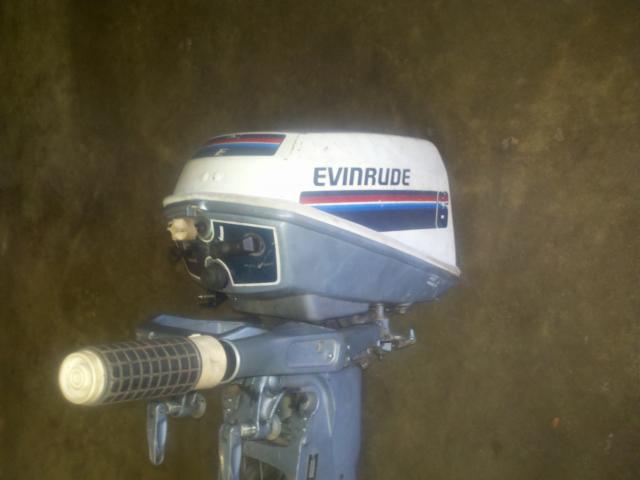

Last weekend, my friend ragged me so bad that I almost went to the E.R. to have a specialest look at my wounded pride. It all started a few years ago when I found him a good outboard for his first boat. My other friend had the motor, but never used it, and was ready to sell it. It was a Seahorse 6hp that they bored a plate behind the carb to match the carb bore. That single mod, seemed like the equivilent of adding nitrous, running nitromethane, with 18 pounds of boost from a roots charger... and the **** thing hangs together just fine. Just draw the starter cord back and its running from dead cold. Same thing when its hot. It just doesn't care. So with his "pro mod, top fuel, mountian motor" he ran circles around me all day on the river. Not just circles around me, but circles in a flat bottom 16' overpacked johny with 2 people, around my 12' V bottom with just me a tank of gass and a motor. So I need help. I must make my 1978 6hp Evinrude fishing motor outrun his 6hp motor. Where to start? I am entertaining any and all Ideas. This includes powerhead swaps. It just has to look like that ole 6hp that I own. Any help would be greatly appreciated. Ill have many pics of mods and parts that anybody may sugest to mod on this thread. So for entertainment value, stay tuned and watch this evolve to something way bigger than the wife is going to tollerate!

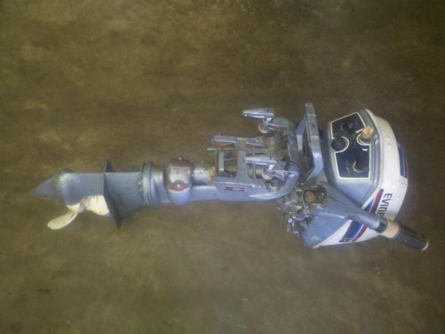

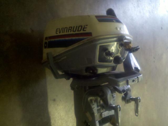

B Walker, Pirata, and Mike 45... I am fully prepaired to bore, stroke, change octain, and nitro, ethenol, methanol, "leafblowersupercharger", nitrous, intercooler, what ever. Not afraid to turn money into noise at this point. I'll get some teardown pics on here soon. I had a look at the reed cage yesterday, then had to screw it all back together to get my workbench back. but its "On" at this point.

Originally posted by Aqua Zombie View Postok.. here is the mill I am working with...
