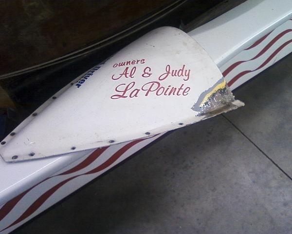

                      Charley has some improvements: chine repair neccessary from the addition of balsa filler to extend the chine lower to the bottom (used to be an inch higher stock and now lowered app 2") and a crash cracked this area.
                      Many hours were spent carefully applying epoxe resin via a vet hyperdermic needle one bead at a time and stuffing glass filings and mat strands down the entire fill area. Of course this would not be possible if Jimmie had not loaned his boat rotisery to let gravity set those materials in the correct spot. The crack appeared to be 2 to 3inches deep and 28 inches long.
                        more

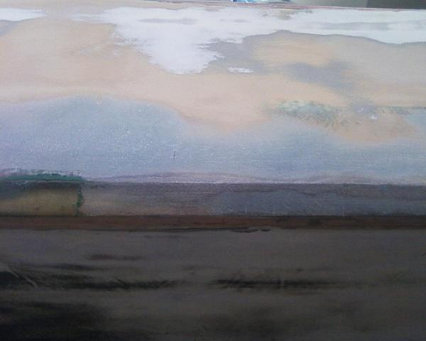

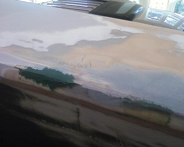

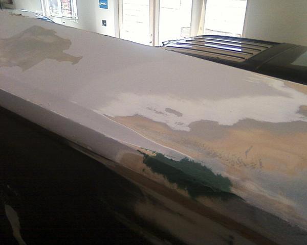

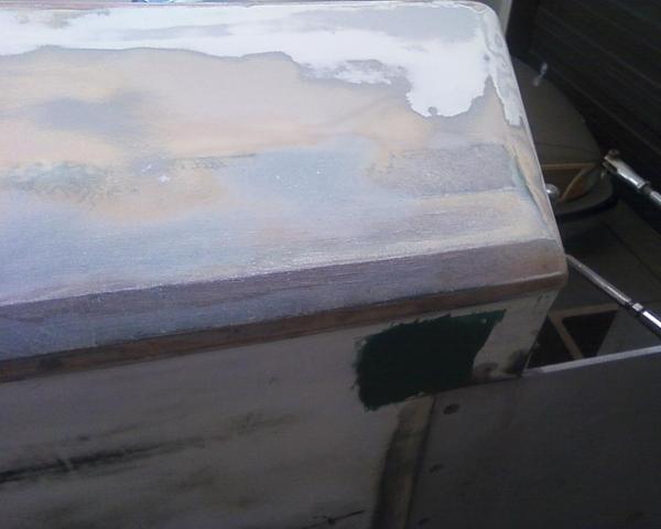

                        Note, the whole boat bottom and sides has been blueprinted (filled and reformed) with that pink stuff (body bondo) and there is where the problem lies, bondo absorbs water. Peelin goin on everywere thats 1/8 to 1/4" deep. This all has to be ground out and replaced with figerglass reinforced marine filler. I have more itching going on than a poison ivy victim! Robin and I are quite excited to bring this one off prototype to life! I found a 1965 sbc 327, shouldnt this boat deserve a period correct engine?
