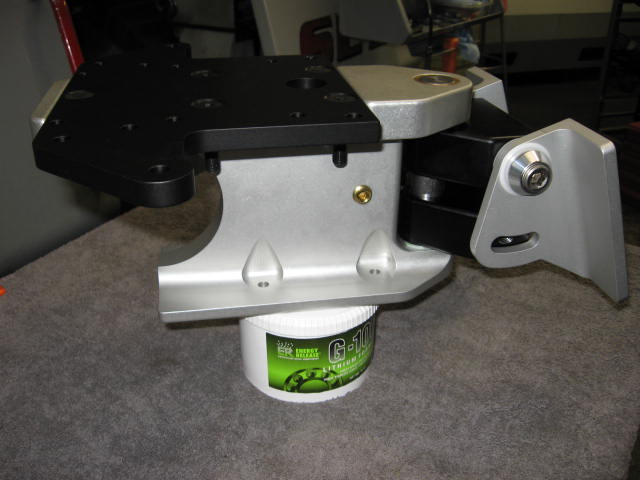

  • New part of the puzzel for my D mod this year thanks to Lee Tietze at Machine Components. He can do some amazing work with a chunk of Aluminum!
    • That sure is a nice looking piece! Although I don't own anything made by Machine Components I wouldn't think twice about buying one of his parts. Everything looks top notch!
