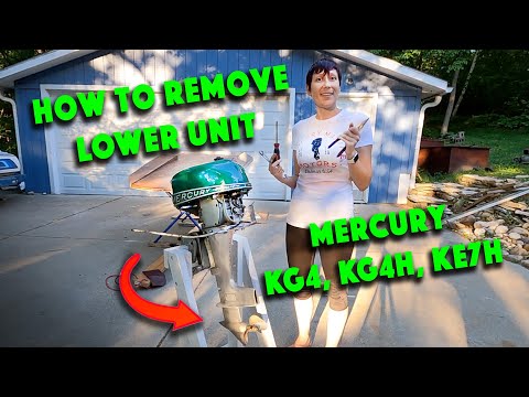

                The gearcase is the only really rare/valuable part on this engine, so I want to make sure it doesn't turn into a paperweight, so I'm having it serviced by a 4 time national hydro champion; Ron Thomas down in Milwaukee:
                Thanks Ron!
                Also, my GF is low key excited about this little thing and offered to help, so she offered to learn how to take the lower unit off:
