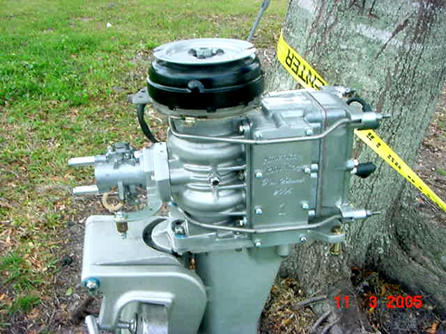

    A couple of pics of the new Hot Rod 'A' as seen at Ocoee.
    Brian Hendrick, #66 F
    I like that wire , to hold them together.

          Actually, the photos are of an all-new 15.cu.in. B Stock Hot Rod (although the A will probably look the same). On the Racecrafts, we drop the transom 1" to adapt for the Hot Rod. As long as you build the boat so that about an inch of the transom can be cut off, you should be okay. Ed.
