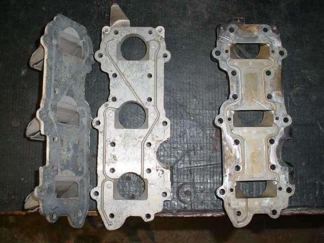

    Well, I'm still playing with my Fe motor.. So, I'm screwing around with the intake, Carb and reed plates. I decided it's easier to get another reed
    set-up i can trash in machining a new carb adaptor. What i have discovered is a 1985/70hp has a much better reed set-up then a 1976/75hp.
    The reeds mount on the same plate as the carb (not seperate) and the "manifold" is a much better interior shape. ie. smoother flow.
    I'm sure other guys are aware of this, but I wasn't, and thought I would pass it along. the omc number on the good plate is 323689, it is between the #1 and #2 carbs..
    now was a 85 a larger displacement... ? the bolt pattern is exactly the same as are the reeds.
    2% own 90%, that's the ownership society
    Three cyl manifold
    The correct part # is 389395, they used it on the 56ci blocks also.
    example: old two peice on left, single peice on right.
    93-C

        sure, you can can take at least 3/16" off the front case, where the reed plate mounts. 3/16" takes @ 1 cube/inch out of the crankcase. Or stuffs the crankcase by about 1 cube. Seems to add mid range torque.

                        my point was, sure an intake shouldn't be glass smooth. But on the other hand, sharp edges aren't helpful, half the carb with veriterable wall behind it can't be better then the 85 carb plate. Screws sticking thru the reed plate...
