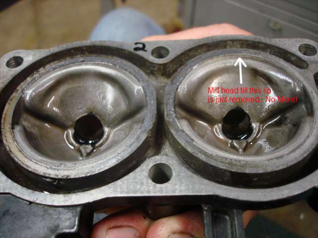

    Tom L. Thanks for the pics,exactly what I was looking for.On the intake pic does removeing the divider effect the bottom end much if any.You have any idea what a safe amouth to take from the head would be without doin the clay or wax.Im not needing it to be on the ragged edge,just about 1 step from it.The pics are exactly what I needed if you have any more ideas what to do im all ears.I did not know there wee 2 different boysen reads,where do you recommed getting the right ones.Thank you for you help.Aaron

            3. The cylinder head can usally be milled down to where the step at the head gasket surface is just gone. This will usally give you about 25cc cumbustion chamber volume and still not hit the piston with a stock .050" stock head gasket. See attached pictures.
