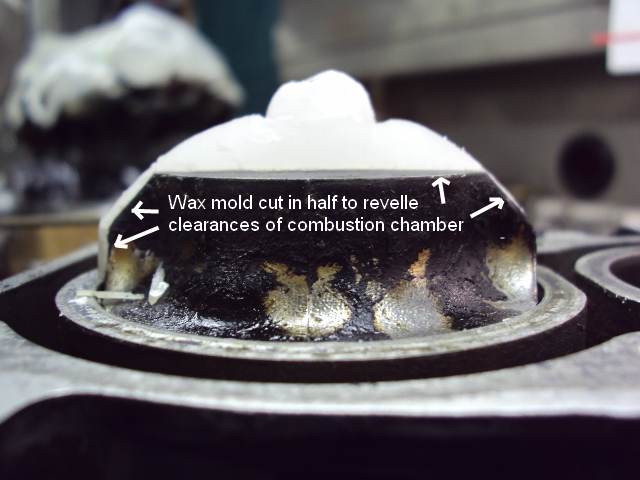

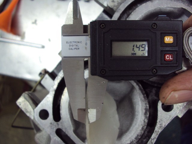

                    Another thing you will see with the OMC 15 is that the higher compressioon engines, meaning those on the smaller side of the allowable cc's for the chamber are typically slower than those in the middle of the tolerance, as per Ed Runne, who is one of the APBA inspectors.
                    Thats not to say if you started stuffing more fuel, maybe alky, and then raising the compression ratio you could see something. Before you start milling a head, take some modeling clay or a soft piece of solder and stick it on top the piston, then torque the ehad and gasket and run it to TDC. Pull out the modeling clay or solder and measure it. You most likely can cut a lot more than .025 off the head.

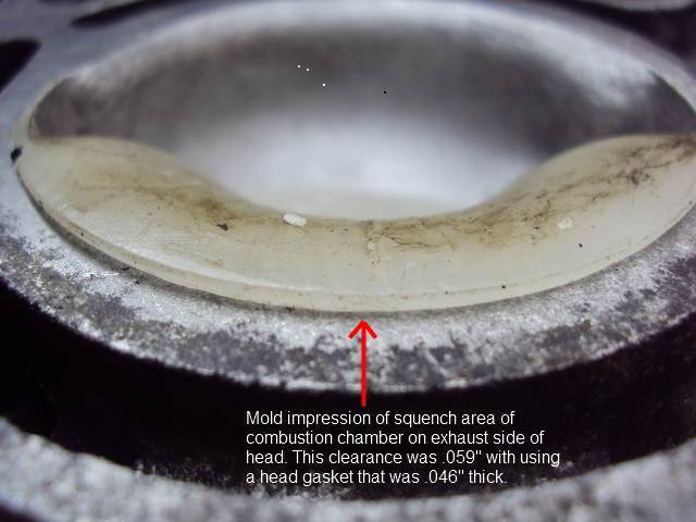

                      Another way to check head clearance
                      You can also use parafin wax used for canning.
                      Melt on stove top in double boiler.
                      Raise piston to TDC.
                      Pour hot wax into spark pug hole and let cool.
                      Remove head and measure clearances.
                      These motors hit the top corners of the pistons when shaved to much.
                      Measure twice cut once.
                      Tom L.

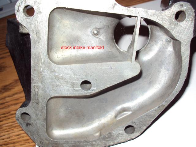

                            Casting flaws
                            I found Boysen reeds for $25,id prefer tdr but at $25 the boysen will do.With the intake off ill also look at what i can clean up in there,basically checking for casting flaws.

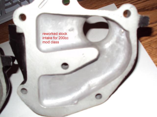

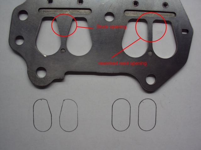

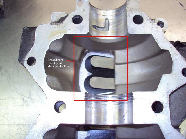

                            Just a few notes pics to take what you want to for your build.
                            If you want to, the reed plate can be dressed to allow more flow for the Boysen reeds. The stock plate resticts the Boysen reed as they have a different shape over the stock reeds. Also the Boysen -R reeds are a thicker reed than the non R boysen reed. (-R prefered)

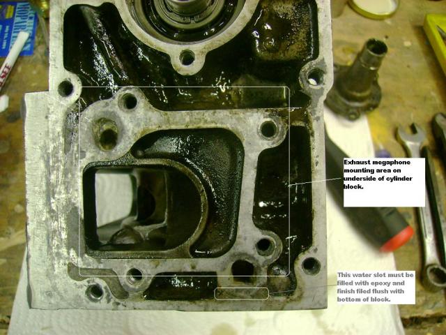

                            The reeds are badly restricted on crankcase side. Open this area up. Do not be overly concerned with crankcase volume. It has little affect unless you go way overboard. Fill the stansfer slot on the underside of the block to dry up the exhaust. When doing so try and go with solid mounts as the stock rubber ones will eventually burn out from added heat.

                              Cooling slot blockage
                              Picture of cooling slot blockage.
