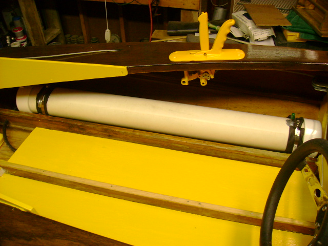

        I made my own PVC - just standard 6" i think it was - about 4.5 gals for an A...used the PVC cement and caps from Home Depot - i had no problems at Top O...
        venting was the only problem i had...Vent has to be the hightest point and be able to withstand the sloshing of fuel! opps...

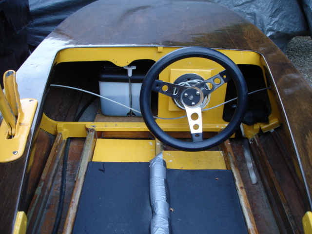

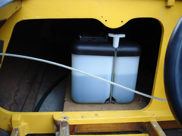

            Just a FYI. We switched over this cottage racers fuel system to the OMC oil injection 3 gallon tank. If you have the room they work very well and mount easiely with their quick release hardware kit. You can find new and used ones on e-bay.

              for a while i had a 6 gallon plastic tank up front forward of my wheel but the way things are made up front, after a few bumps i would start to crack at the seam have to re epoxy everything.. big pain.. so im going back to side tanks but want nothing to do with wood. so i guess the bow idea is out just because of the outward rather than inward force. i think ill pass on using the tanks, but thanks tom. im probably looking for a bit more fuel capacity as i have an incurable rookie fear on running out of fuel 100 yards from the finish line. i was thinking of something along the lines of 4 gallons in the sides and the .6 gravity tank that would fill from them, and if it was a rough day i could fill the grav tank as well and run the extra fuel. weigh isnt a huge huge concern with me.. ill just be happy if i finish something other than dead last or dnf. any ideas on sizes i should shoot for to hold about 2 gallons per side? and just a thought tom.. i used to race buggies off road and my fuel cell breather had a long hose that went to a high spot with a filter... perhaps a bit of fuel line run right to your cockpit ( or up through or to your deck) to a high spot might help with the breathing issue and sloshing... its a thought turning in my head for mine anyways.

                  Well after much thought about the fill caps/deck plates and all the hassle we opted to just hook a 3 gallon outboard fuel tank with primer bulb to the engine feed line of the tube (lower bottom/stern of tube) and fill the tube till gas came out the vent hose at the Top/front of the tube. It worked great. In fact it actually gravity feed by placing the 3 gallon tank on top of the engine cowl. We opted not to install sight tubes to monitor fuel level as they sometimes break or come loose then you have gas all over the inside of the boat and empty fuel tanks. The two tanks were connected using a "Y" hose to keep the fuel level the same in both tanks while running. Just make sure the feed lines are as low as possible in the hull when doing this.

                    OK if you love math you can calculate it out. If your lazy like me just buy one long piece of PVC in the diameter you can fit into the space your dealing with. Put an end cap on one end. Stand it up on end and fill the open end with water using an old one gallon milk jug as your measuring device. Heres the important part, keep track of how many gallons you pour in. After you have the amount of liquid in the tube you want mark were your fill line is on the outside of the tube. Measure the lenghth to the line and cut your second tube to that lenghth also. TA DA two matching fuel tanks. Make sure you drill and tap your two end caps for the fuel feed fitting BEFORE installing the cap. Do the same to the top/front of the tube for the vent. This way you can clean all the plastic shavings out before putting everything together.

                        what i did for filling was to get one of the PVC "trap" i think it was called...like a y joint which has a cap that you would unscrew to run a snake through...was only a couple of bucks and had a gas cap included.
