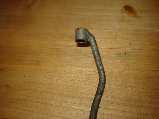

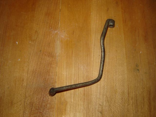

                Inclosed is a picture of what you need. It is a factory part sold as an accessery. It picks up on the top of the carb and rides along the tiller handle where it picks up the throttle cable. You will see a provision on the handle for the cable. This has compound angles to fit the engine. The one I have is new and never used, just sitting aroung for years. ....Bob
                  Ke-7
                  Wow. Looks like a tire iron in the pics! Does the end at the bottom have a hole for the cable to thread through? This is kind of what I had in mind when trying to fabricate something. I think it would do the job with a little oil on the sleeve at the carb end. Do you want to part with it? I may try to weld something up still.
                    Yes the other end had a hole in it for the cable and also a screw to tighten. You don't have to do anything to it to fit the engine. Again this is a factory part made for these Mercury engines. The only thing you have to do is cut the part on the carb that picks up the stater. If not the spark arm will hold the carb open when the ignition timing is advanced. The other method is to remover the pick up on the stater, (two bolts) so the timing and throttle are seperate. Yes I would consider selling it. It is the last one I have and have not seen one of these for many years now. Something like this could be made but the compound bends for clearance make it very difficult to get right. Let me know your thoughts.....Bob

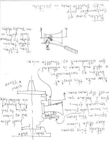

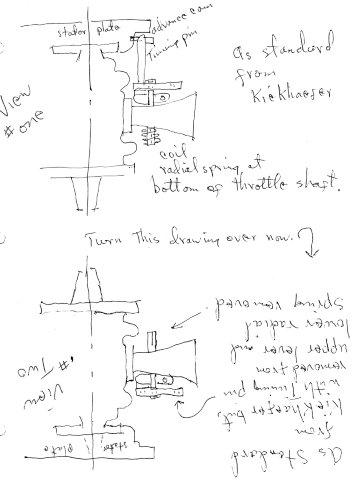

                      I just spoke to Charlie he is going to draw me a picture for changing the linkage from the top of the carb to the bottom. He has a motor already rigged up this way but he could not remember which one (he has so many) so I could not get any pictures. It really does not seam like a diffucult process. I'll scan his drawing and place it here. I will try to have this in today.
                      If you look at the carb you can see the pin moving at the bottom with a small spring on it that links to the top linkage. You are basically just reversing this.
                      The way that Bob is showing is the original bar that Carl K. sold for this when keeping the cowling on the motor.
                        Ke-7
                        Appreciate the input from everyone. Would be interested in adapting the carb for connection at the bottom. I saw a picture in a book of this setup, but it's hard to make out other than the cable is heading toward the bottom of the carb.

                          See if I did this correct. If not send me a private message with your e-mail address and I will send the pictures that way.

                            Thanks Mike for the drawings. I'll have to look at the carb to get the full idea. Looks like I have a few options that I didn't have yesterday. Thanks everyone.
