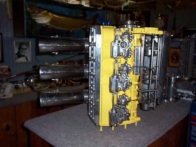

With the tremendous increase in power Sled gave the OMC triple in 850 Mod ... these mods on 6's would no longer be class killers they would have been when FE was first written up
I'm certain Miss Vickie's boat (if set up to do so) could shred Cheney's record any day of the week
I assume that is a piston timed 3rd port on those side carbs, and not reed valves?
-and a 60" block?
Very nice indeed
ps; I often wonder if we should not have mandated stock exhaust plates on the 497 triples in FEH. All the 'grunt' would still be there, but with out the top end.

Look at the transfer port cover above the bottom carb ... looks siamese to me. With the exception of a very few replacement blocks (many bought by Quincy) siamese port 6's are 66's

NICE 6 you have there !! Anything Lon touches turns to something fast !!
