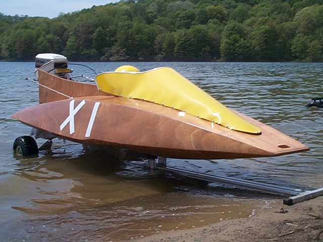

    Has anyone built one of the J kits , It looks like a great boat with proven history. Any coments or other other recomended boats? We will be running a Merc .. I told Jack he could have a runabout if he did well in the hydro last season.. He one region 1 hi points .. Guess I better live up to my end of the deal..
    Yes, A great father son project. Boats are fast also. Can run J, AX and A.
    Started one a while ago for something to do and had to put it aside with other boat building projects and serious family matters plus a broken fibula. I highly recommend the kit.

      Jake runs one in "J" and "AXS" with good results. His father Gregg built the kit. PM me and I can give you contact info for Gregg if you want to discuss the build with him.
      Tom L.
        The new Jackal kits go together even nicer. The cockpit sides and other plywood frameing parts are cut with a cnc router.

          Who makes the skid fin for the jackle?

        My son Justin and I built one and had a blast. See this old thread:
        https://hydroracer.net/forums/showthread.php?t=7411
        We have plenty more pics if you decide to buy one let me know and I will send them to you.
        Heck, the kit is so easy even a nerd like me can build one!
        You and Jack will enjoy the experience.
        http://www.stockoutboard.com/
          Let us know of different fin mount brackets that have been used on my Jackal runabouts. Darrell
