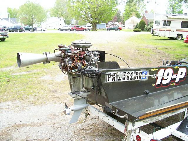

    Finally rig'n my Digatron to my 25MOD OMC......Had a melt-down last Spring at Franklin with my Nationals motor after going to CDI ignition......was just get'n on plane and bottom cyl aluminum fouled plug....
    Talked to Carl Staron and he advised drop'n timing to .280 BTDC (was .350 w/points) and start over test'n.
    first time out I was see'n 1150 on exhaust (probe in elbow about 1 1/2" from port) and 220 on head (sensor under spark plug) ....plugs were tan.
    any thoughts?

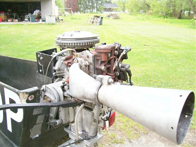

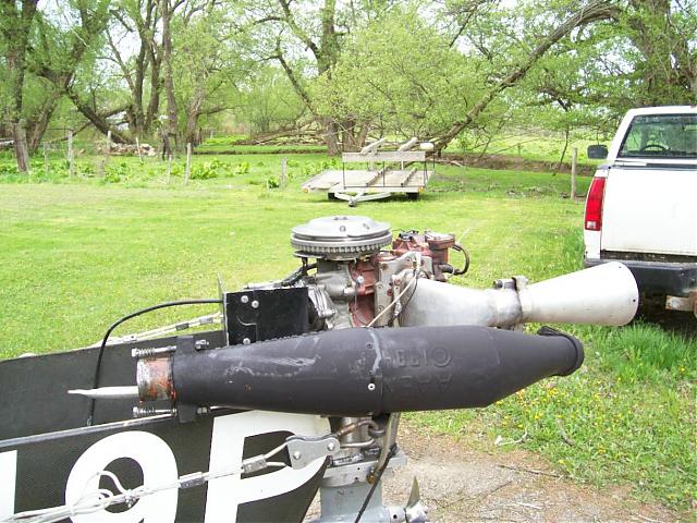

          Read'ns in first post were with a fixed expansion chamber from our 44Merc and probably a factor on temp read'ns........chamber had NO raceable low end and now back to Bayer megaphone......chamber might work on a long KILO run cause it pulled like a freight train once on-the-pipe...just took half the lake to get'er go'n....wanted to test 1X1 foot/props and hold noise down at local lake and avoid tar/feathers when back to boat ramp..........
          Also gonn'a go from a .072 to a .076 jet and see if it stays clean in corners and watch EGT ....Then I guess it's play with time'n time..................

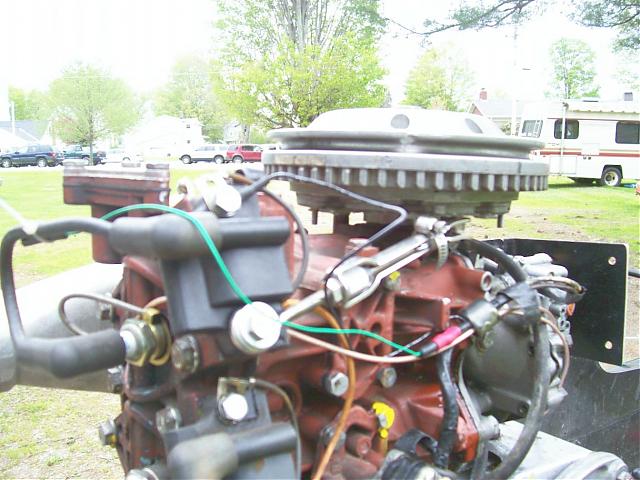

              How are you time'n your's?.....I used a dial indicator and marked flywheel at TDC/.250/.280 BTDC.....using crankcase split for reference.....used 1/2" drill and timing light and have sailboat rig'n-turn buckle to adjust.

                  with CD ign I time with light to about 32 deg
                  look around and you can find the newer CD flywheels that have degree scale
                  or measure off one, I just make marks for 25/30/35 on the older ones

                          Steve, Im guessin thats an AB foot, is the skeg sometin you did?
