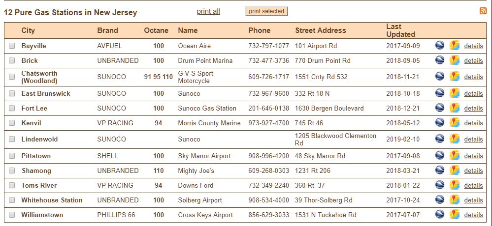

      do you have smart phone use app
      Pure Gas
      will show stations around that has alcohol free fuel. use on the way to races will direct to stations.

        Unfortunately for Dave (and me) he lives in NJ, where there are ZERO gas stations that sell ethanol free fuel. Best bet is VP or Powermist fuels.
      Maybe a racer coming to the race from an area where they sell E free can bring you 4 gallons?

        NJ does have have non corn gas
          pure-gas.org New Jersy shows 12 area to find fuel some airports also gas stations and a Morris County Marine

            John............those stations are mostly VP Fuel distributors or sell AV gas. I think the goal is to find PUMP Non- Ethanol free gas like we have here in Maryland-Virginia. My local non-ethanol free gas station has 87 octane for 2.79 a gallon last time i bought it. Heck, now and then i treat my truck to a tank! I love the tee-shirts you have. Our Balls Products continue to work great. Hope all is well.....

            I am afraid John is correct. There are no gas stations in NJ that sell non ethanol gas. The ones on the app have remarks stating they do not sell non ethanol. That is fine because we have plenty of regional airports to buy Av Gas from. I guess what I am looking for is why one would buy one or the other.....Price, performance, personal preference.....etc. When I was racing my my 2 stroke minimoto bikes I used Avgas. The imported bikes (from Italy NOT China) ran very high performance race engines that required at least 100 octane and zero ethanol..... Heat and lubrication were critical factors as the tiny engines would put out (under 40 cc) between 6 and 18 hp at 15000 rpm. So I just assumed everyone ran Avgas but I am too new to the Yamato engines and want to keep mine in top condition........
