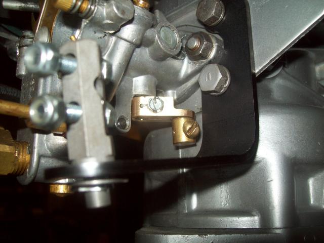

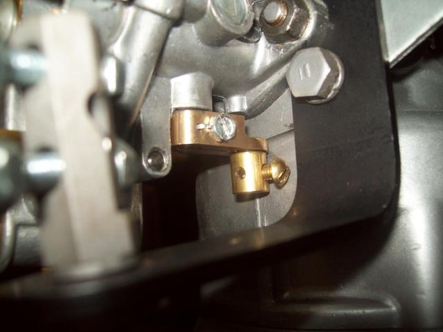

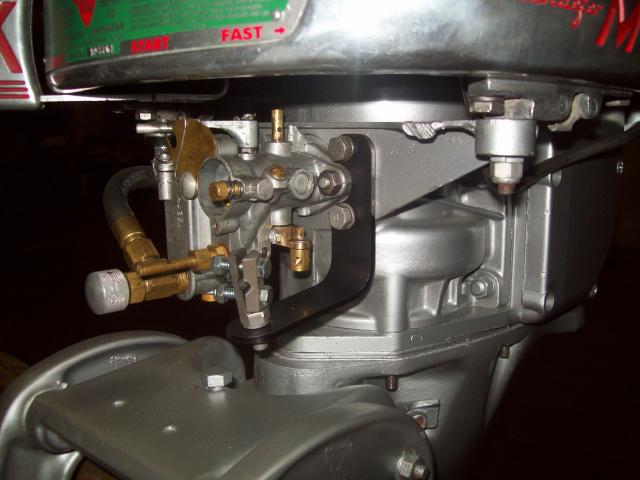

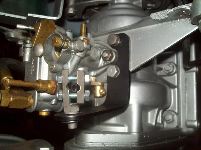

Im stoked!! I just got my throttle linkage in the mail from Frank Erion. It is a bueaty factory clone of the original linkage. Very well made! The guy was nice enough to hand write constructions for me on how to put it on, and even allow me to call him for help If I needed it. Now that I have this motor mostly together I am ready to mock the lower unit up with the transom and finish this boat. Guess its time to learn glass and resign!
AZ, could you provide a couple of pics, different angles, of the linkage assembly. I might replace the one I have if the engineering/functionality is better.
Thanks,

AZ, great pics, thanks for the detail, my setup is almost identical w the cable clamp and bent arm support.

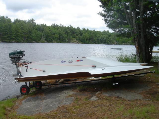

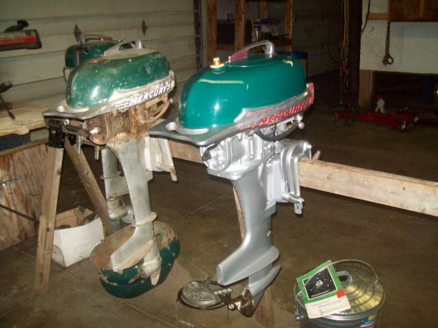

Your engine is mint! I'll PM my phone #, want to discuss your refurbishment process - my KG is torn down, block/tower ready for stripping/painting and want to compare notes. See mine attached on a 20SSH hull(a little heavy). I have lighter ASH hull on which I will run it this summer.

The motor looks sweet.I am glad to see Charlies drawings in action. The man never ceases to amaze me. If thier is anything you need to know about the old mercs I'll bet he can answer it. The only downfall is he does not use a computer.

Originally posted by Aqua Zombie View PostThats a good lookin setup hydroid! She looks mean! I bet the lighter ASH will really scoot! Go ahaid and pm me sometime and well chat.
Want to know if you sodablasted prior to spraying block/tower.Stock Outboard Racing!....because other sports,....golf, football, baseball, etc....only require one Ball!
