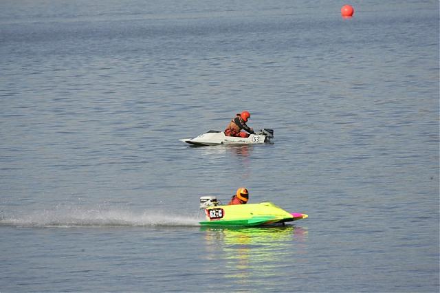

        Every painter will give you a varied mix of their best results, so, here is what i did. The boat came with epoxy, very rough. So, we wet sanded it smooth, then double checked we had not sanded through any epoxy. We did in fact hit a couple small areas, so, I recoated, let dry, then sanded again. On the bottom we decided it to be left as wood, and I chose House of Kolor clear. Blew 3 coats over the bottom, sanded with 800, then 1600, then 2000 and rubbed with liquid ebony. Taped the bottom rolled it over. House of Kolor loves selling their products, which are more expensive than others, so we chose Dupont epoxy primer in a very light grey color. The light grey color was chosen because the base coat for HOK paints is white, and this way we could see any sand through if we had it. Then, it was Neon yellow, Rosea, and Apple green. Each color had to be coated once with clear, because you cannot tape over the neons without causing distortion and some peel. After the entire boat was done, I roughed the clear with 600 wet paper, then blew three coats of clear over the whole thing. The process of 800/1600, and 200 wet paper was used all over, and rubbed in the final with liquid ebony. I did not like my daughters choice of flaming, and we are going to redo that before Bakersfield.
