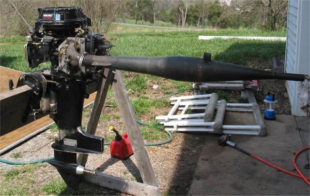

    Look'n for a chamber to werk with on a 20H For A-MOD.......25SS for 25MOD.
    If anyone has a set that werks for a 40-44 I would be interest'd............
    Thanks......100N

            Hey Earl!!.....Just tinkr'n with that old Green("Lightning") tank'd 20H powerhead that I ran at Charlie's "Fun-Run" last Fall..........Screams with the converging Quincy stack but have tried to add several mid and rear chamber sections to it and just kills it...........I looked at the pipe in pics that George S. had on that old Defebo 25SS motor, and Archies wrap-around chamber on his 25SS, and several 44's at Wilson last Summer and most seem to have a longer lead-in to the first cone.
            The "LeBlanc(?) chamber on the Hot-Rod A-MOD I bought from Chuck Zolkoske is small and looks like a normal megaphone length into the first cone......Must be the rotary valve "crossflow" Hot-Rod is more receptive to a chamber.....Have thought it would be fun to try this pipe on a 15 Sidewinder but without the rotary valve, it might act like the Merc.......???......Wish we had more small cube "loope-charged" motors...........
