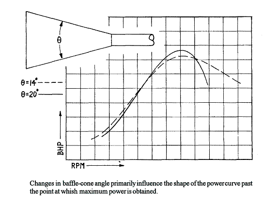

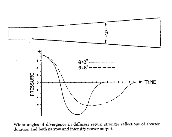

                    Found my copy of Jennings book on 2 cycle tuning. Here are a couple charts that tell the story on cone angle. You can plot a field of curves for cones. The smaller the included angle the flater the curve. The right hand chart tells the story of why we tried 10 degrees. The attached link should take you to an online version of the book. It is worth reading. http://www.vintagesleds.com/library/...20Handbook.pdf
                    Alan

                      Don't want to sound like I'm arguing because that's not my meaning. I don't have the education to argue about something like this....
                      Throw out all the expansion chamber stuff. We are working with open ended megaphones.
                      What would a straight pipe do? No megaphone at all. Just a straight pipe all the way back? Seems to me that would concentrate all the energy and make the power band very narrow. What am I missing here?
                      EDIT: Thinking about this kind of stuff makes my haid hert!

                        A streight pipe would sound great but if you used it in a 2 cycle engine you loose the reflected wave that helps keep the new charge in the cylinder and builds a little dynamic back pressure. The chart on the right shows that the energy is being lost as the angle gets smaller and shown by the 6 degree cone plot. Were only talking megs at this time, Chambers are a different story though and a whole new science. Harry Brinkman was playing with a lot of things. I will post some photos when I dig the things out. He had one set of pipes for a 20-H that had a long streight pipe and the a 20 degree cone. I also have all his notes that he did not publish.
                        Alan
                          No, a straight pipe reflects, it just does not get concentrated ... well not actually concentrated, more like "makes up a little for the weakening due to time and mechanical loss"
                          Its right there in Jennings' book ... where that graph comes from.
