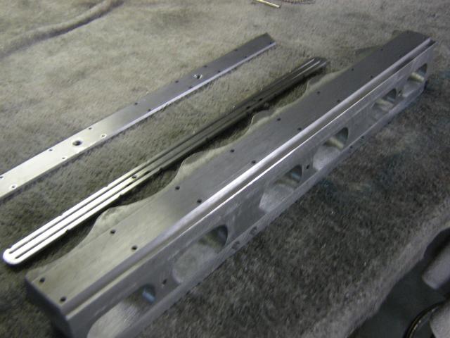

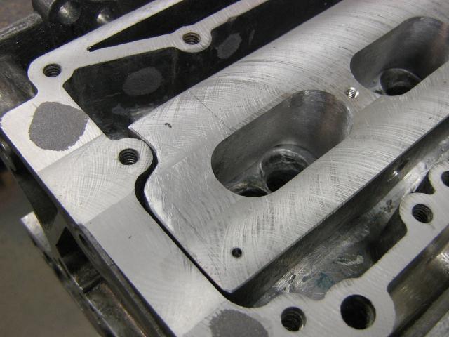

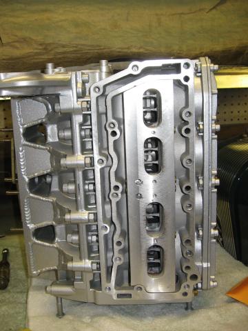

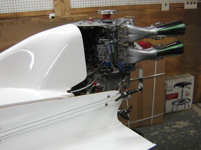

                Here is a photo of the parker stacks we use with water cooling. The six cylinder filler block is at the start of making it fully water cooled.
                Alan

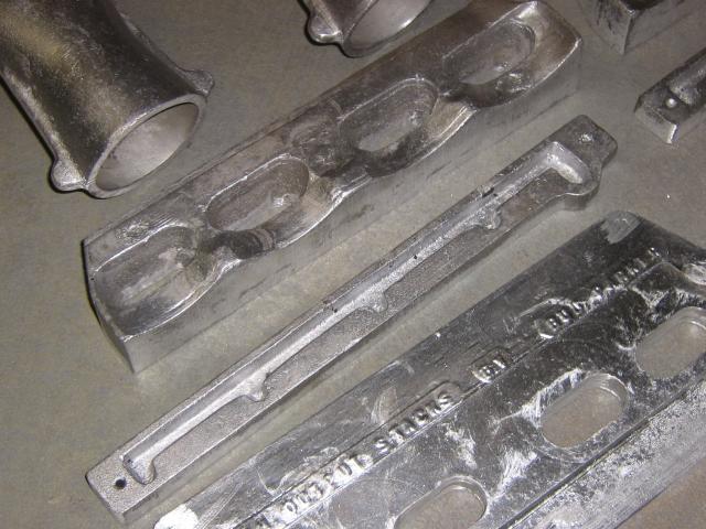

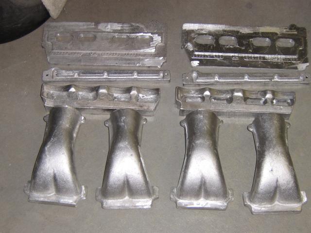

                      Parker Stacks
                      Over the past few years we have basicly moved to the parker stacks for all our engines. Tim Kurcz provides the raw castings and Doug Kay completes the finishing and fitting. Hope the photos help.
                      Alan
                        That's beautiful ^^^^

                          those are great pictures of some fantastic work.. Thanks Alan for posting them

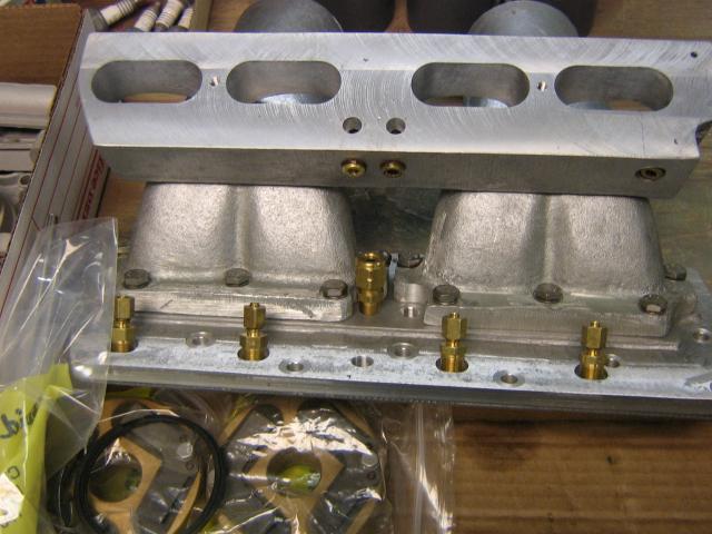

                            Another new project
                            I have had this SE engine for some time. It came with the Harry Breinkman items I acquired a few years back. It has also been sitting up with Doug for some time and decided to finish it up. It will be mounted on a Brinkman tower like all our MOD engines. Tim Kurcz manufactures the stacks for this engine and I will post some photos of it as it progresses. Tim is also doing the powerhead work for it so we will see how this engine will run.
                            Alan
