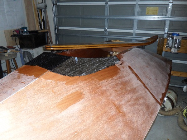

    Late June (20th) and my project seems to have stalled out.
    I applied a cost of epoxy to the interior of the boat a month ago to seal it. after 6 hours there was no sign of the material hardening. To my horror I discovered I had mixed 2 different hardeners.
    So now the battens, bottom and frames were coated with sticky glop. I recoated with properly mixed and several different mixes so now the (mostly) surfaces are not sticky. What I'm afraid of is the hardener that soaked into the uncoated areas will never cure out leaving a soft undercoat. Well, I have no choice, at least most of the affected areas are going to be below decks.

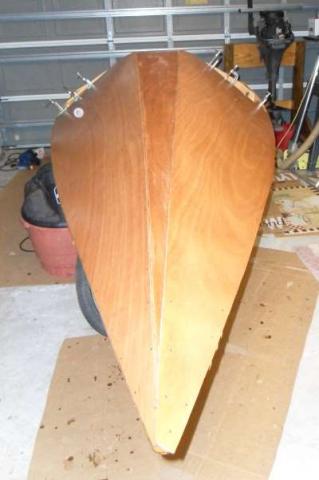

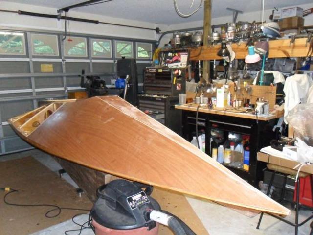

        Couple of times. Left messages. What we have here is a failure to communicate. I guess I'll have D K make me one from a drawing I sent him. Meanwhile there is progress. I have my midsection back, the boat has steering and the front half decked. We had a driving rain all day today or the deck would be 100% on.
        No room for layout in the "shop"!! Here's the latest pics

          Looks real nice.. Hopefully I will get my block some day since I have a boat.

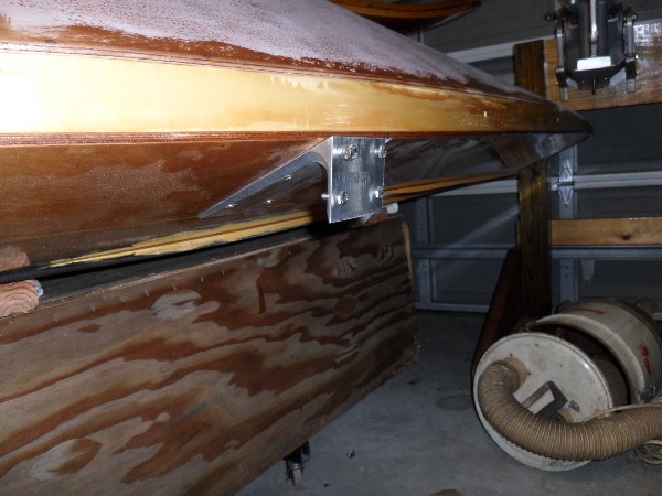

                Fin and bracket
                Mtechmarine sent you a pm. Talked to Mike today he has what you need fin and bracket. He called you and left message with someone for you. Call before 8:00 am Iowa time. Hope this helps!

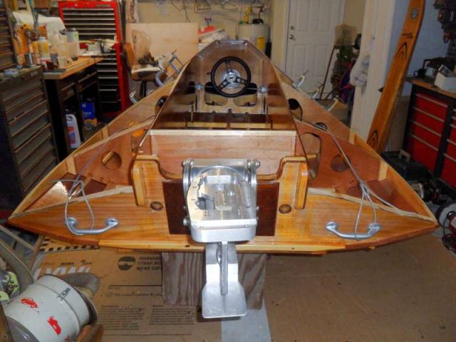

                    Fin
                    Your welcome Randy

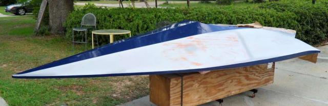

                      Aloha all, here's the latest. I got ahold of Mike who was very helpful and sent that fin I needed. It's a beaut. So now the decks are all on and last nite I added some reinforcements to the cowling.
                      It has been brutally hot here and with the southern summer humidity the heat index is 115!
                      So progress has slowed somewhat, but the decks are ready for sanding and epoxy primer, I hope to get the system 3 primer by this weekend. I have some nice Sterling for the finish.
                      My thanks to Randy for the help in getting the fin.

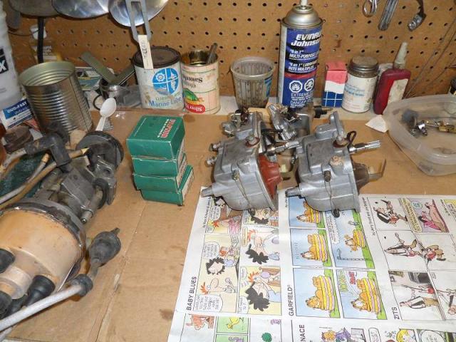

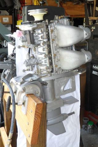

                        ALOHA ALL - Watching that post on Rons site "Mercury Mark 40H" and attending the Mod nationals last year has got my attention, I'm gonna jump back into it. So to start with we did the "oldest D Quincy Restoration". Here's a couple pics of that one. Doug Kay built the stacks for me. It should be no slouch, it will be fun to run.
                        Greetings this is a good looking project !!!
                        i see 1 item you may wish to change , it is the rope pull this was an original mercury rope pull..
                        in more modern times they have been known to come apart and in some cases turn to flying shrapnel !!
                        you may wish to replace it as it will sooner or later come apart ..

                          If i remember right at one time in APBA, the stock crank plate was not allowed to be used for the reason Randy said. This rule could have slipped though the crack over the years. They still are not safe to run.

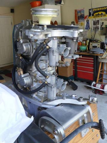

                            AMEN. I have changed both motors to aluminum rope plates. Just took awhile to find them. Same with the tower, you probably noticed we went from Bayer to a Brinkman unit!
                            Still super-hot here. But I'm glad I'm not in Dallas!
                              August 25th, 5 more days I'll be 71! Hard to believe - all the stuff I worked on is "FOJ" now. Making some progress in spite of the heat. Hope to make a race end of September. Still a long way to go. At least the boat is essentially done, I just have to finish the painting, install a throttle, floorboard and some cushioning material for my old bod.
                              Finally joined all 3 big chunks of the motor together. Still working on magnetos and considering the SS setup. I have all the pieces - -
