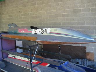

Here's a restoration that I completed yesterday, 9 JUL 14. I bought this well-used and retired boat from Buddy Smith in 1985 and raced it thru the end of OCT 1986. I believe Buddy built the boat in the 1978-'80. It's unique in having a 16" tunnel all the way from front to rear.
I ran the 250 Quincy on it, an engine (Serial #5) that I bought in parts from Christner in DEC 1978. Far as I know, it is the first of the "Z" engines to be raced. The previous engines were all "shop" or development engines. I wore out two previous boats with it, the first a flyweight boat built by Gene Apel, and then the 12' Butts that I destroyed in a crash with Kay Harrison at Sebring in 1985.
At the end of 1986 I sent the cylinders to Mike Schmidt for new sleeves, then decided to stop racing. So I sent Mike the rest of the engine for him to race in RB. He ended up winning one national high-points championship with it during the almost 20 years that he had it "on loan".
I needed a project this spring, and putting the rig back together is it. I plan to enter it in 2-3 races this coming SEP & OCT.
