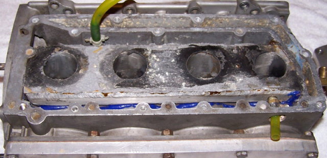

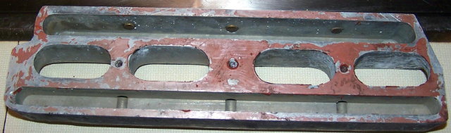

    I don't like dry filler blocks. My C is cooled the way that Brinkman recommended. In fact, he did the work on it. My 44 has O'Brien exhaust. See pictures. If I were building a 44 right now I'd buy a Bayer exhaust from Dudley Malone and water cool the filler block with the welded in water jacket like Brinkman recommended. I've never seen a Parker filler block (Tim Kurcz makes them now) but you may be able to set it up the same way.
