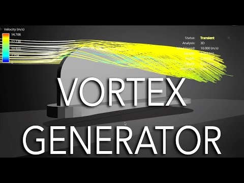

Vortex generators serve the purpose of delaying airflow detachment from a surface (stall). You'll often see them on STOL aircraft as it helps with high angle of attack flight regimes, or to increase flap effectiveness, etc. Unfortunately, they also create drag, so speed performance can be affected.
