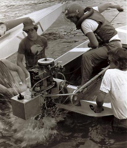

                    ..banned in C Service..?
                    Looks like fun. Why did they ban this class. No shortage of motors. Maybe all the lifters went on strike.
