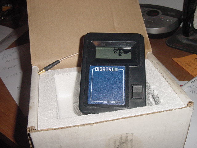

                hey Matt, I have a DT-5E that has been in the box for about 10yrs (don't think it has ever been used), is it similiar to the 6E? I know all it has is a tach lead though.
                Daren
                ​DSH/750ccmh/850ccmh
                  Bingo..............
                  That may work. Contact the boys at digetron to verify!!!!
