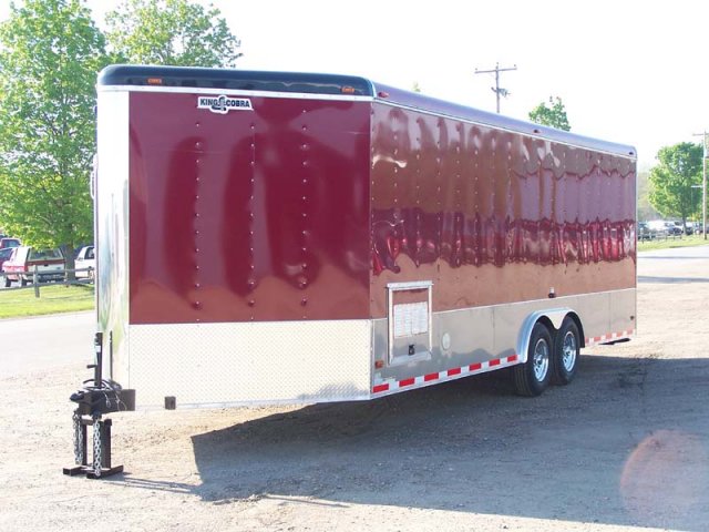

    I just did the same thing and there are alot of manufacturers and more options then you can read about. Im in the process of moving so figured it was a good excuse to get an enclosed trailer I was going to get a Haulmark but couldnt wait for six weeks to get it built. So the dealer said he could get one in three weeks from a smaller company and would be cheaper in the long run as what was options in the Haulmark were standard in the Cargo King and the curb weight was lighter. I wanted the wider car hauler so I can stack the boats on one side and the motors down the wall on the other side and I wanted the ramp door on the back. I still have to pick it up at the factory in Mi to save the high dealer mark up but its worth the trip to save 1500.00. Thsi how I equiped it.
    8.5 wide by 20ft box with a 3 ft V nose makes it 23ft box with a total length of 25 ft.
    6.6 ft high inside by 8 ft wide
    White vinyl walls and ceiling.
    2 roof vents
    2 wall vents
    2 interior lights with wall switch.
    24 inch front stone gaurd
    chrome V cap
    8 inch roof wrap with a abs front roof cap
    2 3500 pound torsion axles with elec brakes
    Curb weight 3000 and gross weight of 7000
    Sealed beam lights
    Under coated frame.
    Crome center caps on wheels
    Total price 6035.00 and the same trailer from Haulmark was 6750.00 plus a 150.00 charge from Haulmark to pick up the the factory. This is a picture of a red one like I ordered but I ordered Indgo blue

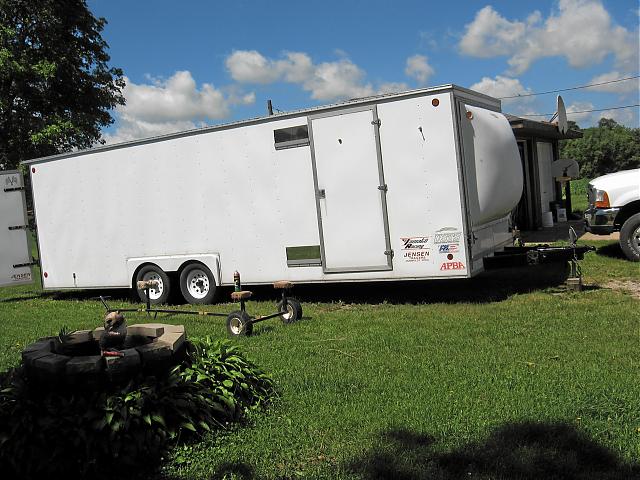

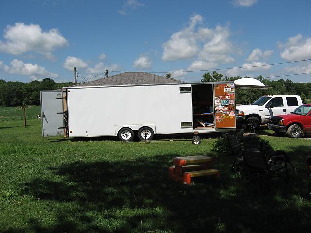

                            Featherlite is made up the road here in Iowa. We went to the factory, but they did not have the time to produce what we wanted in a reasonable time. So, they sent us down the road a ways in Humboldt Iowa to Jensen Trailers.
                            www.Jensentrailers.com
                            We have been more than pleased and have been excited that Featherlite sent us to them. For a reasonable price we got EXACTLY what we wanted, and even visited the factory to watch our trailer being made. They also have instock trailers.
                            We wanted a trailer that was the same width as our truck, did not have a ramp (too many times pit areas don't allow this easily), and opened in the front. Notice on the pics that we had a bubble put on for easier hauling. Our tailer is 24 foot and we have carried up to ten boats with some on top.
                            We love the trailer and Jensen builds a super product.
                            The only thing we would ever change is exactly what Pat suggested-some windows. We are thinking about having them build a gooseneck with living quarters. I talked to them by phone the other day, and everything that I asked for, they could build.
                            Check out the pics open and closed.
