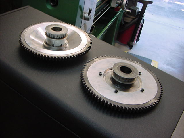

    Anyone know where I can have a crankplate built so that I can run an electric starter on my 44? I don't want to run the heavy stock flywheel. Thinking about something that can be bolted onto the top of one of the small racing flywheels where the crank plate normally is bolted on. Something similar to a flexplate in a car with an automatic transmission.

              Jim Grinstead in CA has made up two different versions with AL flex plates [see pics] Another solution that I have not seen done but should work, is to source a motorcycle rear sprocket blank of the right gear pitch and bolt/weld it on the small hub. A [good, IMHO] compromise is what I am doing now on my DCH 44", but as I have three more races to run this year, am not going to talk about it. Scott is using some sort of 'flex-plate' set up on his 44XS based Dmod, and does not seem to slow him down any. I am a BIG proponent of electric start, mainly for safety considerations.

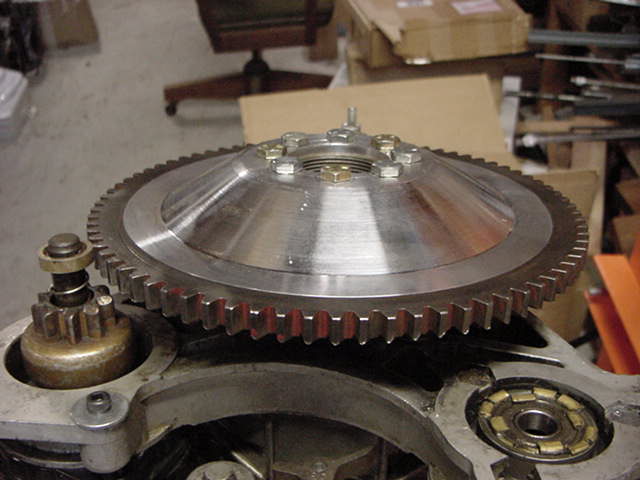

                  I am using a 44XS flywheel which is an SST120 with a 50 hub installed or the like flywheel. The ring gears are a bolt on - then balanced. The issue is this. Those ring gears are not available any longer. The 50HP fishing motor uses a 10 tooth bendix on the starter and the V-6 motors have an 8 tooth bendix the ring gear has a different number of teeth for the V-6 Starter over the 50 starter and the V-6 starter will not fit on the 44 motor. So you have to get an 8 tooth bendix from any starter rebuild shop and then because the starter shafts are a different size from the v-6 to the 50 starters you need to have the center of the 8 tooth bendix opened up on a lathe with a carbide bit.. DO NOT TRY AND DRILL IT OUT TO .500. We wrecked a 200$ ROC drill trying, the bendix is that hard.
                  Or the simple solution you need a 92 tooth bolt on ring gear to work with the 10 tooth 50HP bendix. The V-6 bolt on ring gear is 94 teeth and 8 teeth on the bendix.
                  The rest is just a bolt on, solenoid, wiring to a toggle on/off and push button.
