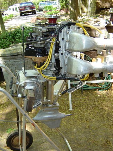

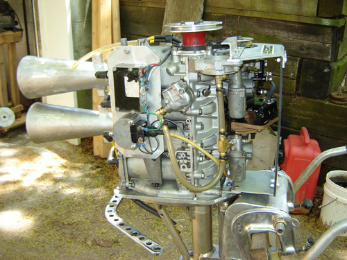

                Merc 500 Ignition
                Originally posted by vislaguy
                hey dave what is a fm mag?? and what is seting the dwell,I'm still learning about the mags and how they work, so far I have had good luck with them but I just picked up another 500 motor and it has a distributor and I thought about trying that setup but really wasnt sure where to start with that. So on a 44 mod motor what would you run??thanks mike
                I just put together a D Mod engine from a Merc 500 and am using the Stock Ignition (Merc Lightning). Not really shure how it will work but should find out in Franklin Pa. on Memorial Day Weekend. I intend to swing the mag for easier starting and to lighten up on the belt. I know it fired on the first pull after putting the engine together. How it will run when wide open is anyones guess right now. Bob Rusnak N-96
