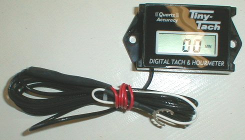

              Briggs Tiny Tach
              See attached for what I'm using on the 102.
              I attach the ground lead on the spray sheild nut and wrap the other lead around one plug wire (make sure you reset the tach). Also make sure your leads are not touching both plug wires.
              This works for me, however, see Eds response to this very question:
              " We also got the jumping around on the tiny tach when we first bought it on the Hot Rods. The way to fix this is to make two wraps of the lead around one plug wire and then the remaining wraps of the lead around the other one. That fixes the problem. $35 is hard to beat. Ed.
              14H "

                  Mark,
                  It looks like you will get conflicting information here but whatever works...
                  I use a Tiny Tach. For the Yamato 102, I wrap the red wire around the bottom plug wire three times starting close to where the red wire meets the black covering. I then wrap the rest of the red wire around the upper plug wire. You can usually get 2 to 3 wraps around that one as well. I do not need to use the white wire to ground. This has worked for me for a number of years now.
                  The Tiny Tach does not work on the Yamato 80 motor though. This motor must ground differently.

                            We have tried the Tiny Tach for years on OMC A's Yamato 80's 102's and 302's, and come up with different results each time for reliability.
                            On the OMC's we had to ground the white and wrap each plug wire 4 times, you will get a double reading for the overall rpm reading, divide by 2.
                            The Yamato 80, 102 and 302 we had to set it up the same way, on the BMOD if you dont wrap both of the plug wires you get number that goes from 8400 to 16800 and back to 8400 on and on down the straighaway. Its easier to wrap both plug wires and divide later, and remember to use the ground wire provided to a clean ground area or it wont be a reliable/consistant reading.
                            As for my personal choice of tach's the Digitron DT52K max works perfect everytime. It gives tach, cylinder head temp and for mod guys exhaust temp. All of this can be played back after you return to the beach, it has a memory to show the entire run from leaving the beach to shutting down. You can also but the interface cable and plug it into your laptop, it gives you a bargraph of all 3 readings that you can save into your computer for later comparisons.
